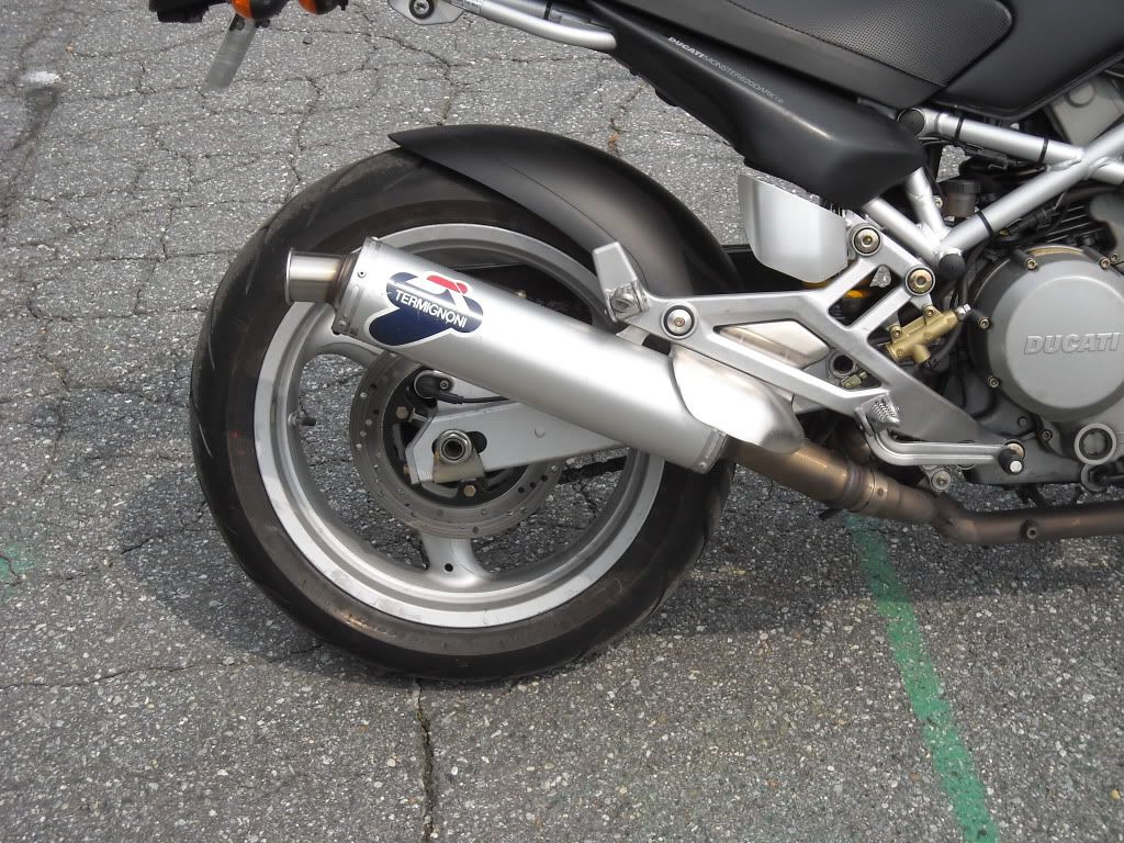

2002 m750, stock except for a K&N airfilter and kickstand bypass switch. It has Remus exhaust which I had heard were not the stock pipes?

Remus is a supplier of both OEM and aftermarket exhaust. A photo will help.
