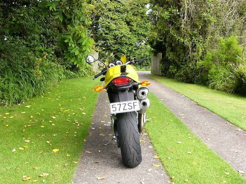

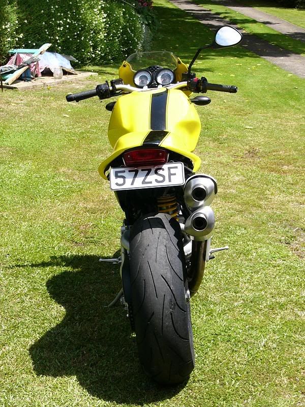

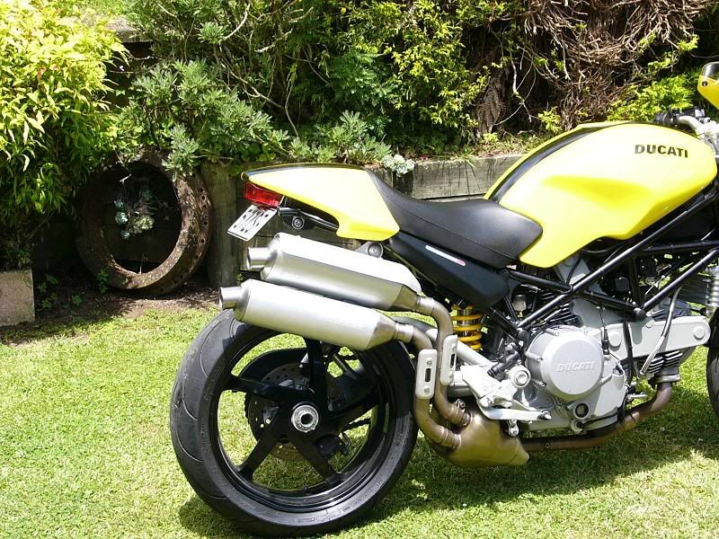

Well cut that beer tray off this morning, just waiting on same frame plugs from "micheleracer" he  sent me some mirror plugs and caps for the cost of one set, awesome!! for such little things they do tidy up the holes etc very nice. Led tail light on it's way too.

Just so you know, siding the forks up in the triples is easier than turning up you preload. just be sure you have the bike itself supported before loosing the hex bolts. Then gently lower it to the desired height and retighten... make sure you are in allignment though, when I did mine I was just a touch out and it caused me shoulder/upper back problems for weeks until I figured it out.

Thanks Wannaducbad, I will have look at that then, don't want to drop it to much as it may (20mm max) as wouldn't it have a impact on handling?

Yes I have had the mufflers off, and yes it sounds like a Duc should, and could live with that, not sure if the bike could though!!!???  run lean wouldn't it?? could you get away with just a re-tune and a dealer? has the stock setup have enough scope for that ?
Scottish
My little brother has a S2r800 he runs that way... I know another guy who runs his S4Rs, and a girl with an S2r1000 that way too, no problems. I see no reason it should run lean. Frankly my Termis with the baffles out probably provide less back pressure than an open system with the cat still on would. There are even dealers around that sell systems that even eliminate that as well. Watch for the boom tubes in the upper right corner(board sponser). And the open air box that comes with the Termi performance kit is nothing more than a stock box lopped off right above where the clips hook in. From what I've heard the thing you'll really need to watch as far as fueling issues go is the o2 sensor. Check the tech section, if I'm not mistaken I think a lot of the guys like to remove them as a way of solving a low speed lurching common in those models.... check that before doing it though. I don't remember the details. Mostly get out and ride the wheels off that thing!  ;D

I don't think I have the o2 sensor, is that in the udder? as I have no probes etc anywere on the exhaust system. Yes have seen the boom tubes, think I will make some little pipe extensions if I ran with out the mufflers. At this time in thinking and can't really afford a new exhaust system, but can change it to get a better sound, cut out the udder or recore the muffles???

Ah yeah, definitely about the steering damper and such. I just know that I can't afford to replace my suspension with a set-up built for me at the moment so I look for ways to optimize what I have. THus the fiddling, and it helps. I won't argue that  it's comparable to a full Ohlins set-up but it's better than it was. As to the exhaust, I only have a system cause it was on the bike I bought, I couldn't afford one at the moment either(I got mouthes to feed). That's why I recommended yanking the cans and opening the air box... once again optimizing what I got. As for coring the udder?? Frankly I haven't looked in one and I'm completely unfamilar with the workings. Though from my brother S2R800 I would venture to say it probably isn't neccesary, I think most of the plugged up feeling is coming from the mufflers.

Your right as with the suspension, to me it's firm and fairly solid feedback, as I have said alittle light and twitchy in the front at high speeds, otherwise for me it feels damn good, at 5ft5in and 70kg I am nothing more than a blowfly on this bike! [roll]  maybe this is too that I find the brakes OK on this bike, seem better feel than the ST, but is less weight for sure than the ST.  Meaning to cut the udder right out and just join the pipes up to the stock muffler pipes etc. the udder is the cat converter and would be better off with out it.
