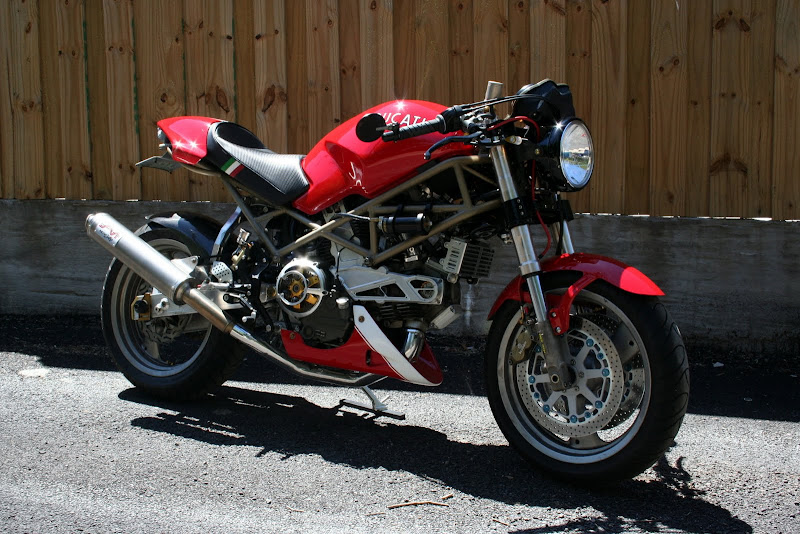

I've had their parts on my bike for a long time - there is a picture of mine in the gallery.
I like the parts so much I've ordered up another set for SBK forks.
Note that they come in 30mm offset for the older bikes. Speeds up turn-in a bit. Feels fantastic.
Billet Upper Triple, Lower Triple, Stem, and Stainless Hardware is included. They can do custom fork boring for different forks. Your OEM forks are 50mm top OD, 54mm bottom OD. Showa SBK forks are 53/53, and Ohlins SBK forks are 53/56.
They are working on a complete triple set for SBKs now which is going to be bad ass. I'm teetering on the edge of pulling the trigger for a pre-order.
They speak english, they take PayPal. Shipping is fast.
Order up some new steering head bearings and installation is a breeze. If you get the SpeedyMoto Tapered Bearings, you aren't really upgrading anything, your bike came with tapered bearings. It has upper and lower dust seal included, you pretty much order the IMA triples (270 euro plus shipping plus any special options you want, like risers, etc), and the SM bearings, $105 USD, and you are good to go.

Mid-Progress:
loves ze desmodromics.
Posts: 7355
Re: Pre-2002 Triple Clamp?
September 30, 2010, 01:27:51 PM »
"Finished Project" (at the time)
