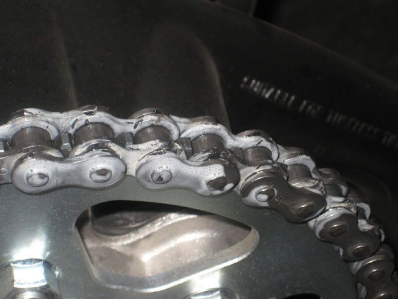

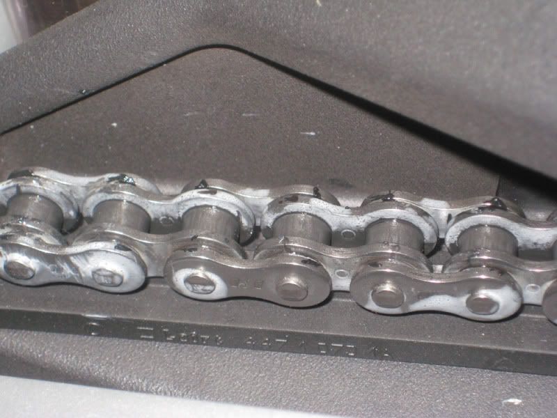

I cleaned and lubricated my chain about 100 miles ago. Since then, I've taken 2 or 3 short rides (~12 miles each ride) and last night went for a 60 mile ride. I noticed today that there's a thick black oil (almost like tar) on the chain. I did park it next to a lawn where the sprinklers came on and a little water go on the left side of the bike, but I wouldn't think water would do this to a chain. Has anyone else seen this black oil on their chain?
Looks fine to me.
You don't need that much lube though.
Spidey
+1 on looks fine.
The outside of the links don't need to be covered in lube.  Just make sure that the O-rings are lubed.  When I lube up the chain, I just make sure it's warm and then focus the spray into the O-rings between the links.  After I've done that, I scrub the chain clean with a rag and get rid of the excess lube.  I only spray the outside of the links as a way of cleanin' 'em.  You'll get a lot less fling that way.

Thanks. It's my first time lubing it, so I guess it just turns black after being ridden. I did warm up the chain before I cleaned and lubed it. I'll ease of on the amount applied next time.

The black stuff is just chain lube + dirt (probably mostly brake dust).  Basically all the chain lubes you get at the moto store will do this to one degree or another.  But, a trip to lowes will solve that problem.  Go there and get a can of Dupont Multi-Use Teflon in a blue spray can.  It's for chains, then even make a version for moto chains (yellow can, not available at Lowes).  It's a proper lubricant wax once dry and collects very little dirt and has zero fling.  Bonus, is it's $5 a can, which is cheaper than any other chain lube I've seen.  Works great everyone I know how has tried it won't go back to other lubes

that is completely normal chain oil that appears and grime with use.
just keep using the chain wax and such every 200-350 miles of use and you will be fine.
