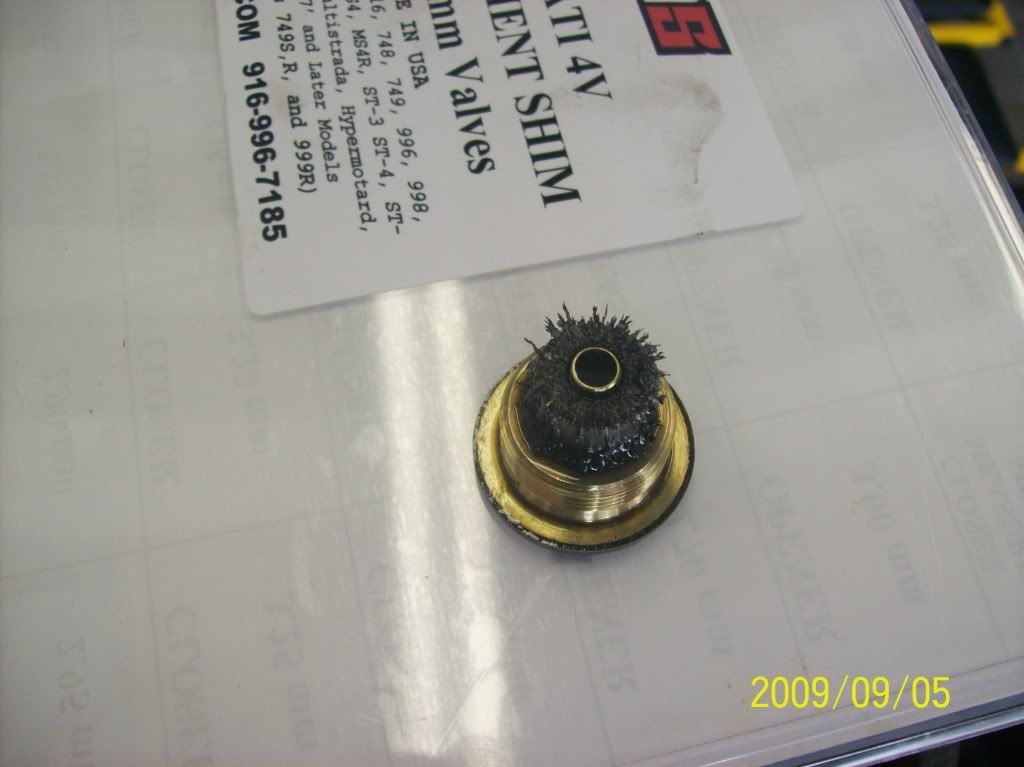

Is this normal? 08 S2R1000 at 22,500 miles? Has looked like this on previous oil changes.Bike runs and shifts fine.

Don't know if it's any help, but I recently pulled one out of a 998 with 4000 miles that looked pretty close to that
Bill in OKC
At 22,500 miles I'd think the break-in is complete.  How many miles was it between oil changes?
My bike had some SCARY stuff stuck to the magnet on its first oil change but I change the oil ~every 2K miles so maybe it doesn't have enough time to build up like in the pic.  But - better stuck to that magnet than floating around the engine.

Hmm... How'd the oil SCREEN look. Any large chunks? If not, i'd say make the beast with two backs it... What are ya gonna do about it anyway? Probably you would just finish the valve adjustment, and ride it hoping it doesnt blow up ;D so go for it!

Just noticed wrong forum should be in Tech. The screen just had a couple bits on it. I have a few months warranty left. I'll see how many miles I can get on it before it runs out.

To me, it looks like a lot. But mine only has 7500 and the most I saw was about half that. Not sure if it gets worse as time goes on.

The picture posted was normal, there will always be swarf(metal filings) in your motor no matter what.
Just ride the snot out of your bike and stop worrying about stuff like this.

Exactly, just run the snot out of it. It should be fine. The manufacturer has tolerances on all of the componants. If some start out a little tight, then you get a little more wear.    Squid- you used the word "swarf" I assume that you have done some machining in the past. New guys at my shop don't that  is a word when I use it. And I use it quite often. Great word.

I don't know but I'd say as long as it all feels soft to the touch you should be okay but if there are a lot of hard bits then that would be a lot worst.

03 800 - 26,000 mi had similar shavings on it; maybe not as much ... but the key IS it runs and shifts fine! no worries.  Your putting lots of miles on her; so maybe use the best oil you can find; personally I like the motul V300 full synthetic green; also I use 15W 50; as recommended by my local Ducati dealership; shifts smoother and seems to run cooler .... everyone will have a different opinion on oil but get the best you can buy and change it often ... 1+ squidwood; hes being cheeky cause hes frustrated by relationship headaches and is taking it out on his bike ...  ;) down boy ...  [moto]

But yea like he said , as long as its not chunks your fine .
