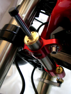

3) Firmly keep your handlebars straight if there is little or no traction on the front tire (to avoid tank slapping).
4) A steering damper would be a good investment.

On bikes with sport geometry, I believe a steering damper is a good investment, depending on how you ride or will be using the bike.

But I will admit that a steering stabilizer is the way to avoid a minimal amount of wobble. Hope that helped explain that aspect from those videos.
