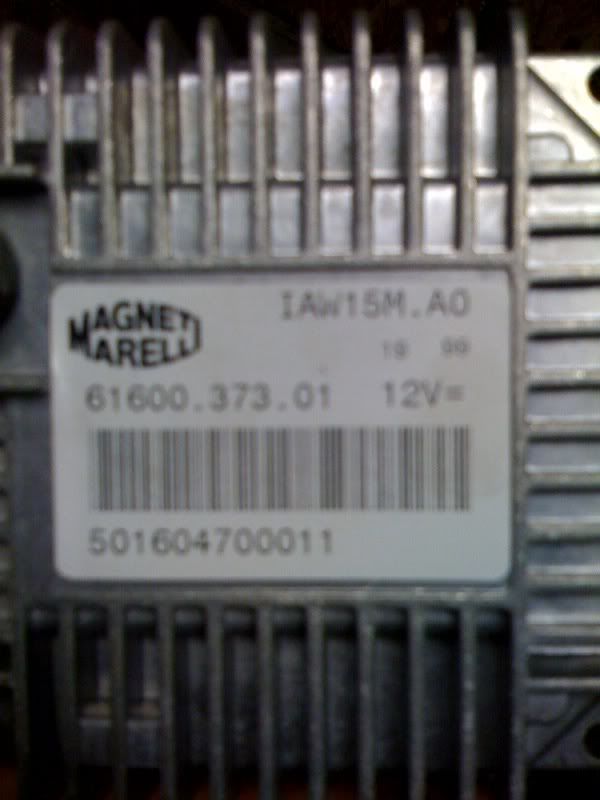

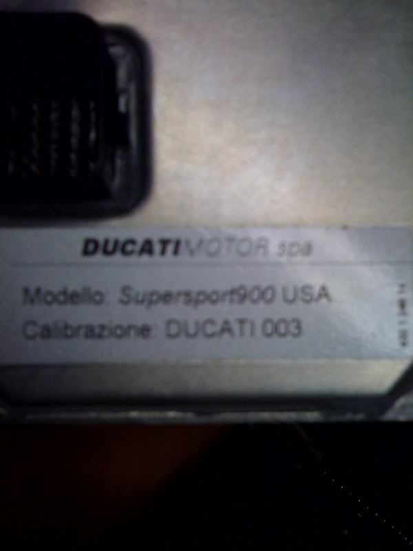

Here are pics of the front and back of the ecu i ran.  Seems to be a 1999 900ss ecu. . .
Does anyone think this is the wrong ecu?
