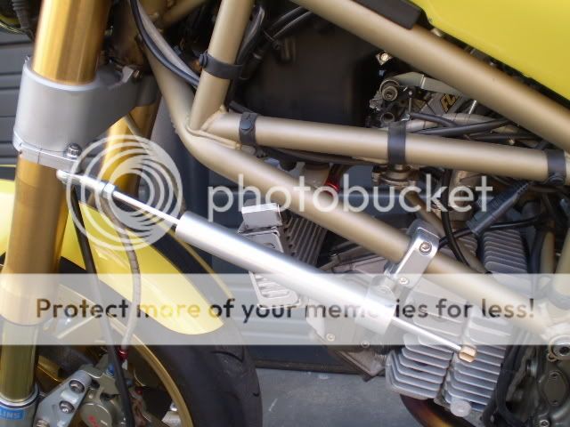

Where can I find these neat straps and stabilizer. I LOVEE this guys monster and I want to find some of these mods.

The straps came as stock tie downs to hide the wiring. Probably wont find too many of those. I think most people have gone with zip ties.

straps. a salvage bike or stop by a local shop
steering damper. again parts for sale

For steering dampers, etc check out our sponsors on the left.
