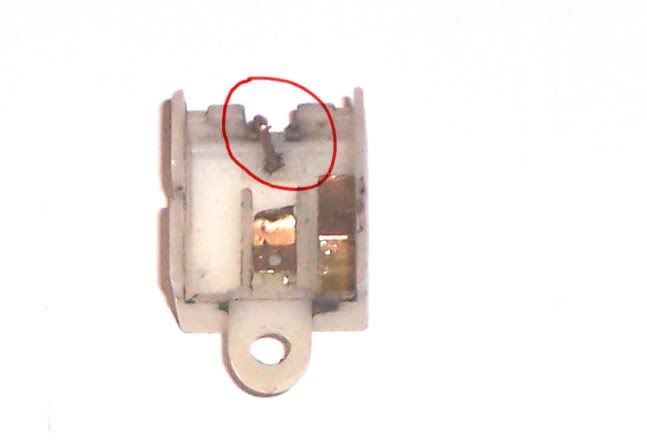

Ok, pull it apart and DP is right, bunch of little pieces. I took a few pics to make sure I had an idea of how things went back together, but ran into a small problem hidden.
the first pic shows the two pieces that fit together, the second is of one with a small copper piece with a hook in it that I failed to get a photo of before it was disassembled. My question is what does it hook?
Quote from: bdfinally on August 28, 2010, 12:46:02 PM

For future searchers reference I pull that small piece forward and down. Gave contacts a thorough cleaning with RS control contact cleaner & lube, buttoned everything up and turned the key...got both low and hi beam and my passing switch works again too!
