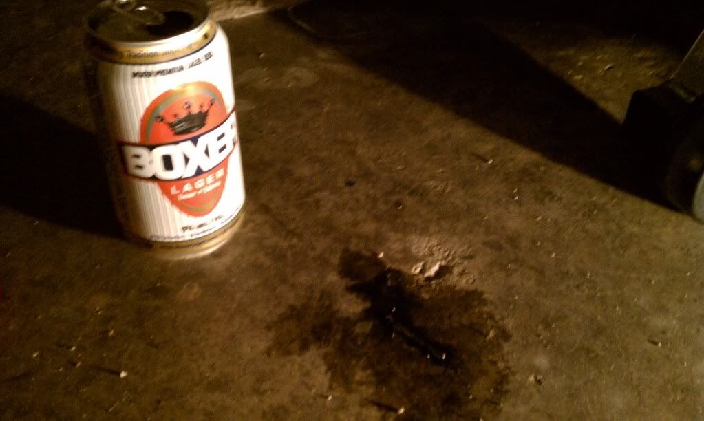

After a short ride down to our local Austrian restaurant (Moser's in New Carlisle, IN) I notice my boot was incredibly shiny. Now since I haven't had my Sidis polished in a while, this struck me as odd. Yup, I had an oil leak. At first it wasn't obvious what the origin of this automatic boot lubricator might be. But, after parking the bike for a bit, a little puddle formed and the apparent source was revealed. The oil was coming from somewhere in the clutch assembly. As they say in proctology, time to dig in.
Armed with a garage worthy beverage and a spooky light, the journey begins. Here, the oil puddle can be seen. I'm sure the British bike guys would laugh at me for being concerned with such little oil on the ground. All I can say is, we weren't all born to be rockers.

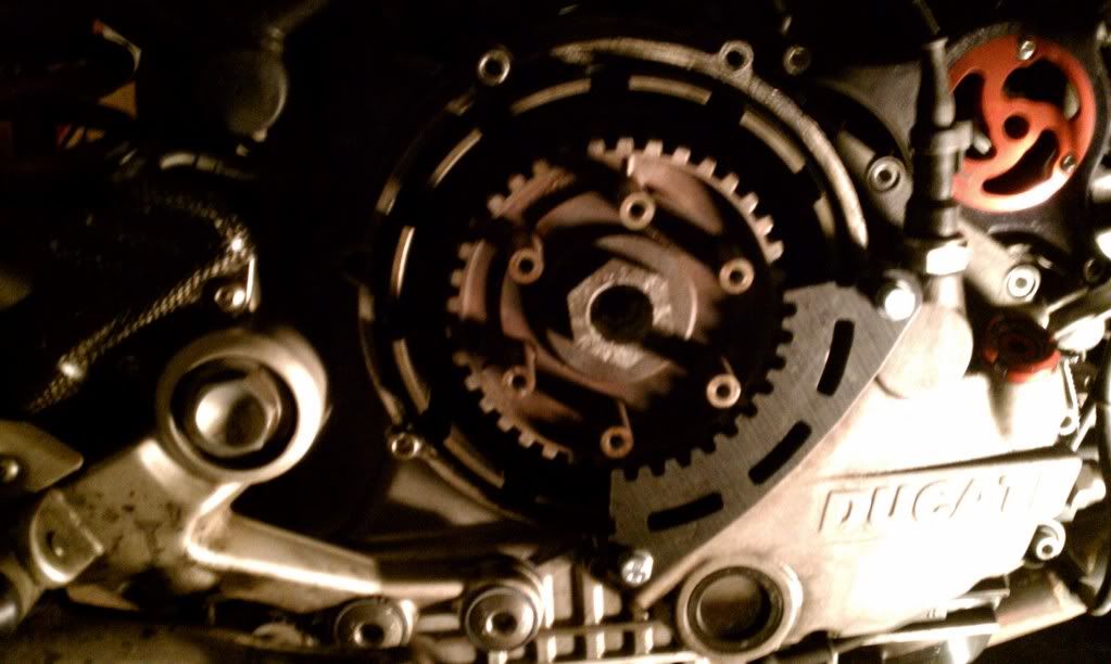

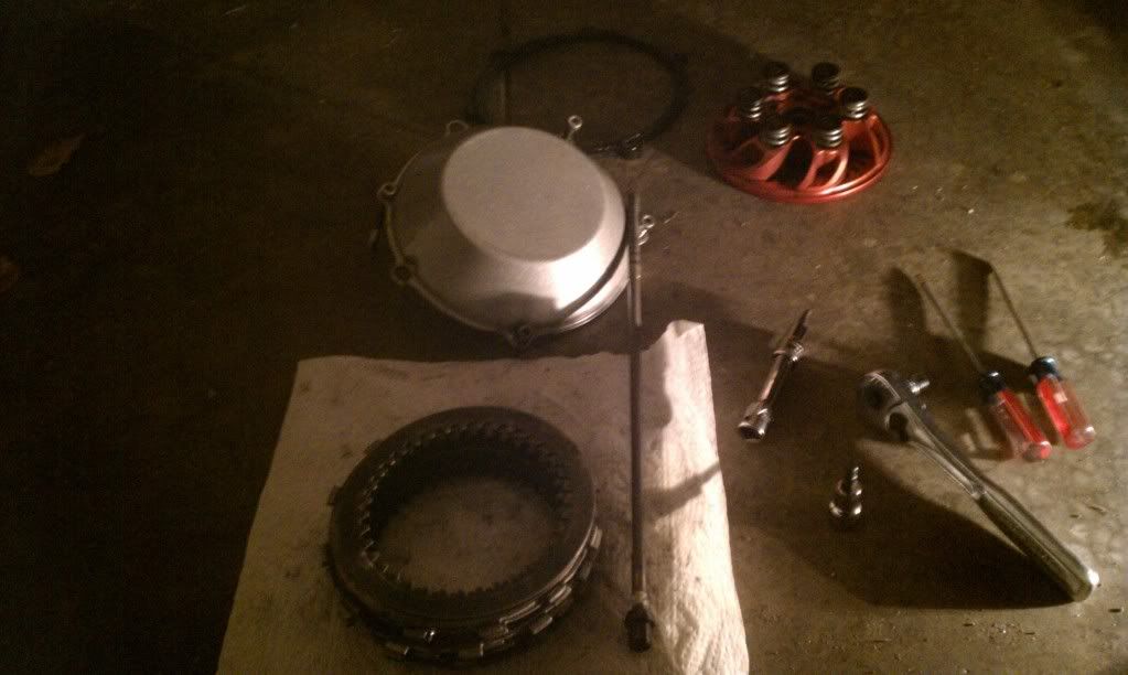

My first thoughts were that the leak was coming from the ring seal behind the clutch basket. I was hoping this wasn't the case as we'd be looking at an oil change and pulling the case cover. It's not that I don't love pulling case covers, okay actually that is the reason. So off come the clutch cover, pressure plate and clutch plates. All pretty strait forward.

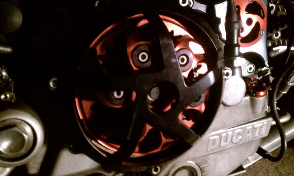

Now comes the fun part. Bolt your handy clutch hub tool up to the case. If you have a dry clutch, one of these babies should definitely reside in your tool box. It's made of urethane or something of the sort but it's solid and it needs to be for this next bit.
So here's the part where cheaters prosper and all those pull ups you should have been doing pay off. If I can say one thing for the good folks on the Ducati assembly line, they can sure torque the shite out of a bolt. Now we take a quick time out for a tech tip.

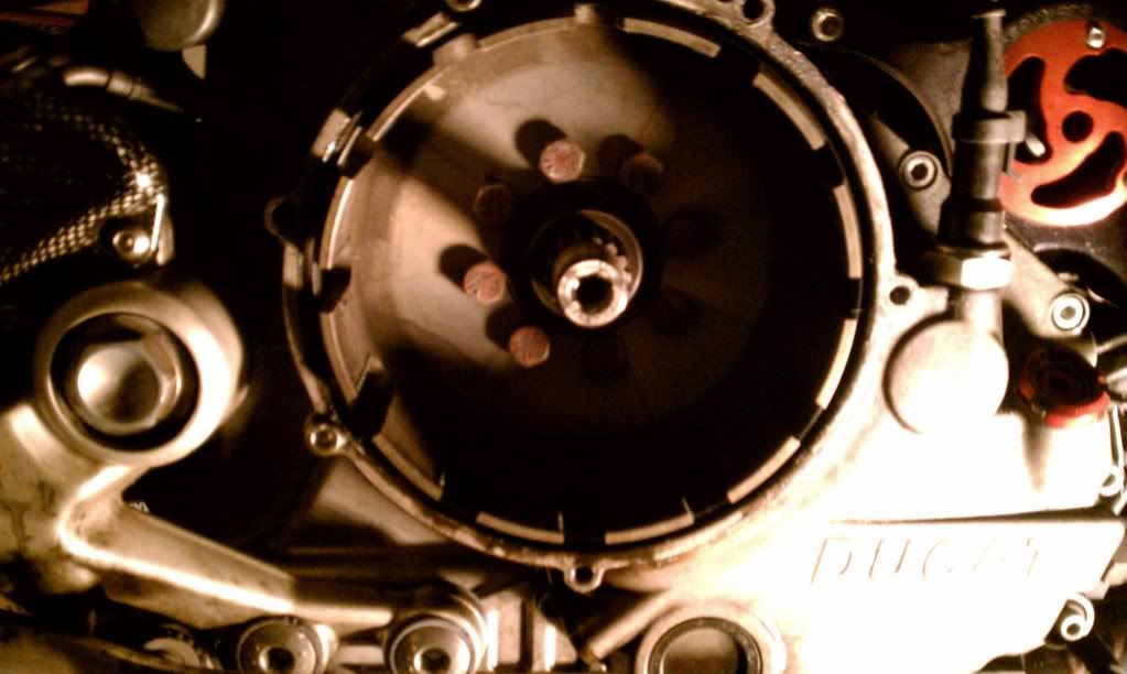

The clutch basket is held on by the bolts you see here. It's a good idea to put the clutch hub tool back on to remove these guys. They can be a bit snug due to the red thread locker, which you will need to reapply during assembly.

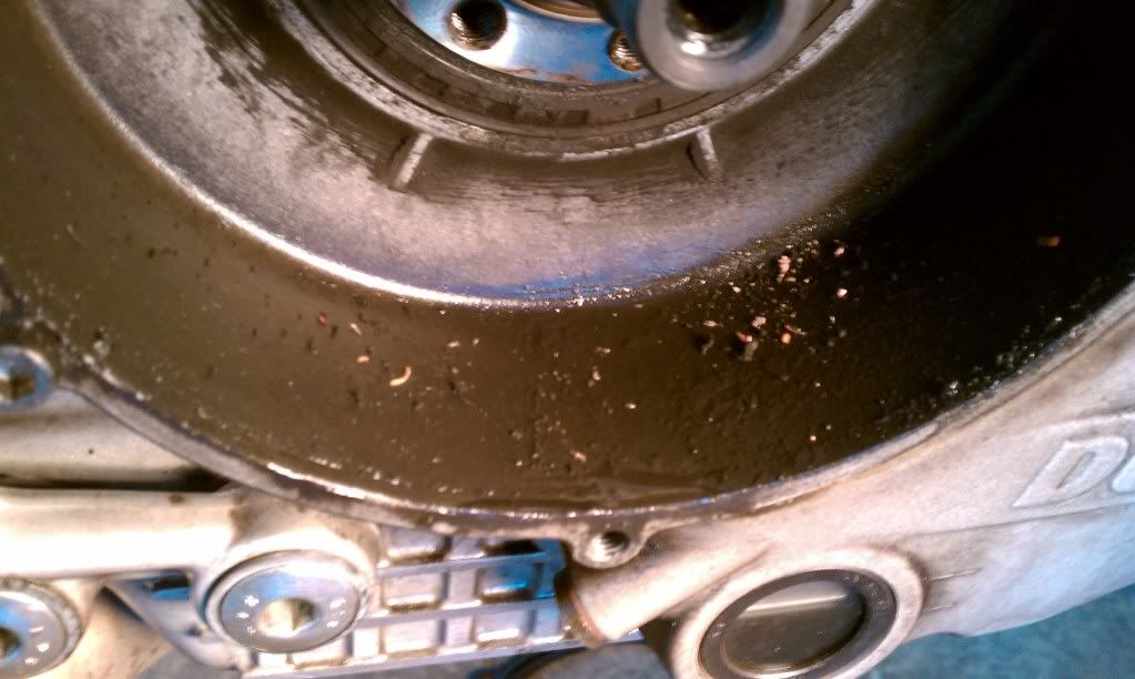

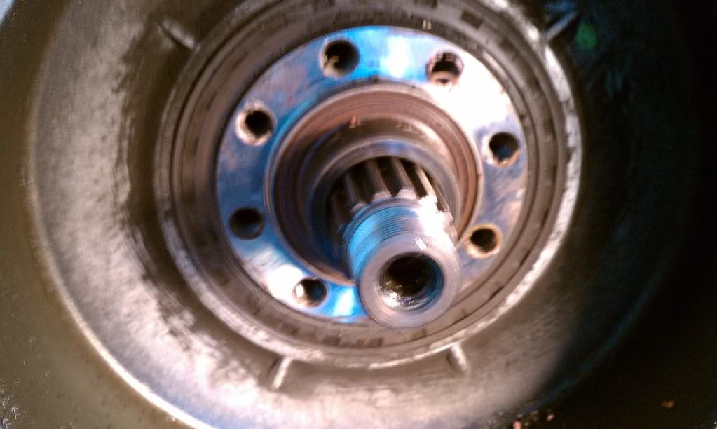

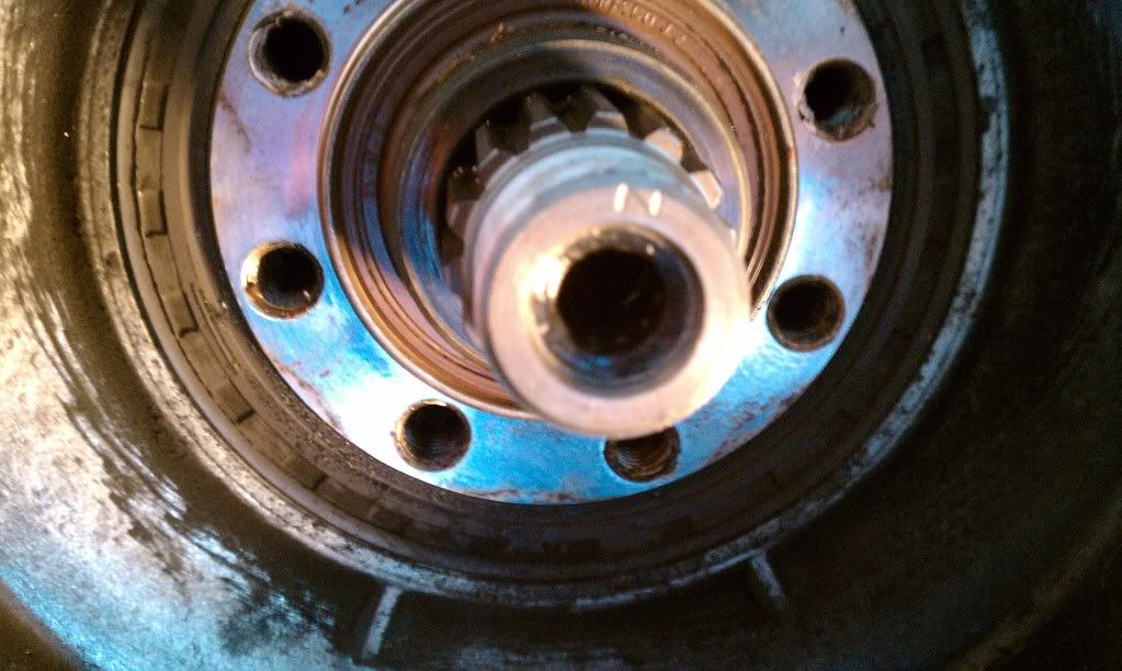

Well, we have arrived. Jules Verne would be proud. A sludge of oil and clutch dust graces the case cover but it doesn't appear to be originating from the ring seal. The ring seal is the rubber thing on the outside of that shiny bit.
It isn't entirely obvious from the picture but the ring seal is quite dry. At this point, I was somewhat baffled as there was no obvious sign of an oil leak. Running the engine briefly revealed nothing.

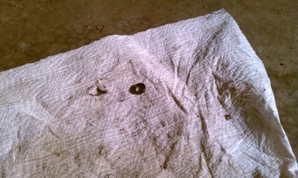

This shot shows the pass through for the clutch push rod. You can see the needle bearing just behind the o-ring. The o-ring was shot. I should have noticed this earlier but I had already made my mind up that the ring seal was the problem. Oil was leaking past this o-ring onto the back of the pressure plate where it was being flung outward, coating everything including my leg.
The culprit in the flesh. The o-ring was well worn and seemed almost brittle in a similar way worn lay shaft seals appear. If you are unfamiliar with the lay shaft seal, it lives behind the crank pulley. If you find oil seeping from beneath your belt cover, your bookie has a 2-3 that it's the lay shaft seal. The good people at Ducati Indianapolis sent the part to me the next day.
