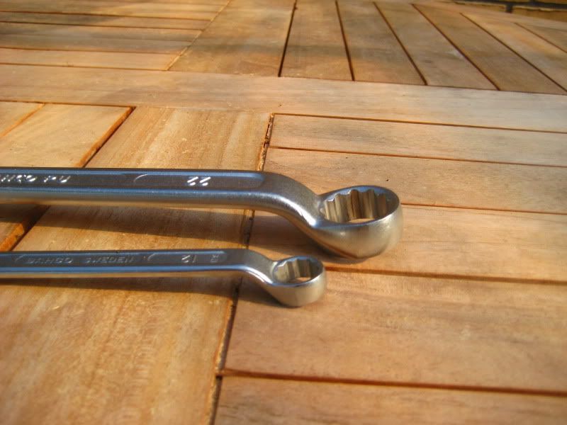

Quote from: CETME on June 03, 2009, 10:21:21 AM
I know this is old, but I figured if anyone was curious, a 22mm offset wrench combined with a 12mm offset wrench works perfect for the adjuster eccentric and fuji nut. There is tons of room to work. These are Bahco brand tools, I bought them in Denmark. If anyone is interested in them, PM and I'll bring some home for anyone who wants them.
Those wrenches are Swedish.   Will a Ducati start after being worked on by Swedish wrenches?
They are a Swedish company, but they are in fact made in Argentina.... so they'll do just fine.
