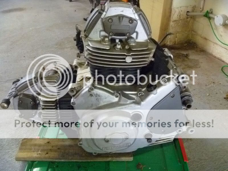

It's a bare engine so the VIN is not available, only the engine number.. and as is always the way, only 'most' of it is decipherable.  Images on the 'net seem to indicate it's pre-1998 but that's as far as I can go so far.
I rarely get this right (posting images to forums) but here goes..
Alternator side:
Clutch side:
Looks like it's worked OK.
On the whole, what I'm trying to establish is where (what year/models) straight cut primary gears started being used.. my old beast, an 84 model 650SL, uses helical cut primaries.  I'm building up a new 'warm', dry clutch motor and I wanted to get my hands on some straight cut gears and a couple of other bits 'n bobs.
(edit:  I should have stated it's 2 valve, air-cooled, of course.. sorry.  It's the only engine config I play with so it's familiarity that breeds my presumptuous stupidity)
Appreciate any insights.
Garry.

brad black
it's a 97 motor i'd say.
750 motors were dry clutch up until 750SS engine number 1500 or something like that, some time in 91.  then they went wet.
primary drives - 750SS â€" up to engine number 007223 â€" 36/71, 1.97:1
      engine number 007224 onward 31/62, 2:1
600 and 400 had the 2.28
all straight cut afaicr.  don't recall seeing helical pd gears for a long time.
