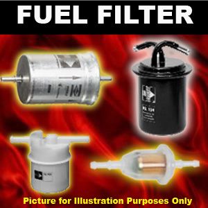

M696 fuel filter part num is wrong.
Started by kokis, April 27, 2013, 03:30:28 PM
kokis
As I know it is 425.4.015.1A
but. I ordered it 2 times and each time my mechanic man says it is wrong part.
That I ordered some carburator engine fuel filters. And yes, google says 425.4.015.1A - is S4RS/06 fuel filter.
What is correct part? And any equal non OEM filters?

kokis
I never seen my current stock fuel filter.
The first one i purchased was like upper left one, and the second which i ordered by number 425.4.015.1A is the bottom right one.
And my technician man says that they are not high pressure filters for injector system engines. Last autumn he had to disassemble and clean up my stock filter manually, which was important to keep engine run correct.

brad black
42540151A is a plastic filter, just like the picture.  that's what they're meant to have.  42540041B is the aluminium one in earlier bikes, 45240101A is the grey plastic fiaam filter in 749 and 999
