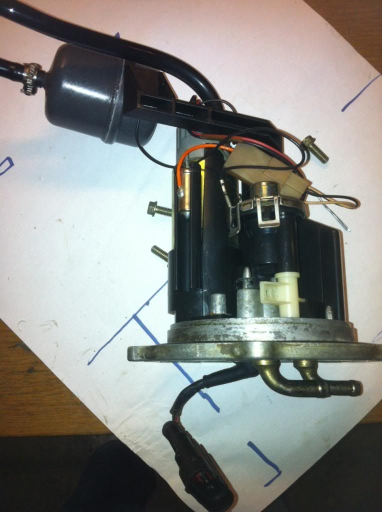

lillemanus
Here is some pic of the pump and I also noted that the pump is more of a loose fit than snugg fit when ie hole in tank is bigger than pump.
I turned the unions pointing forward as the twats who stole my tank cut the fuel lines....
I don't know what that pump is from.
All of the recent ones I've seen have stubs for the fuel quick-disconnect fittings to attach to.
But it has an O-ring on the face of the flange to seal to the tank?

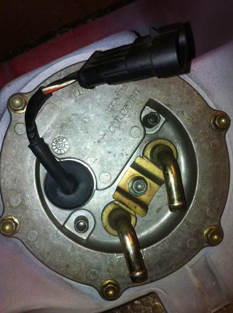

lillemanus
Hi and thanks for the reply,
This one has an oring in a groove on the face on the flange and not  at  the top of the baseplate (like 748 etc)

lillemanus
What makes  me a bit confused is what I can tell from pictures, the 749/999 baseplate  has three bolts securing the plate and not six. Most of the pics where there is six bolt, there is no threaded hole for the union bracket.
Well I fitted the pump, added some fuel and has not leaked for two Days and it seems to run fine.  The future will tell...
brad black
true.  maybe it's early multi.  those connectors were replaced with the plastic quick release for 2005.
Brad The Bike Boy
