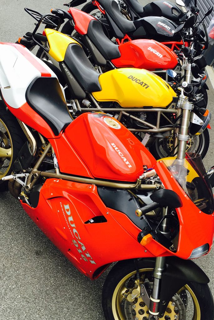

Just to show off - here she is with just a few of her Italian sisters  ;D
