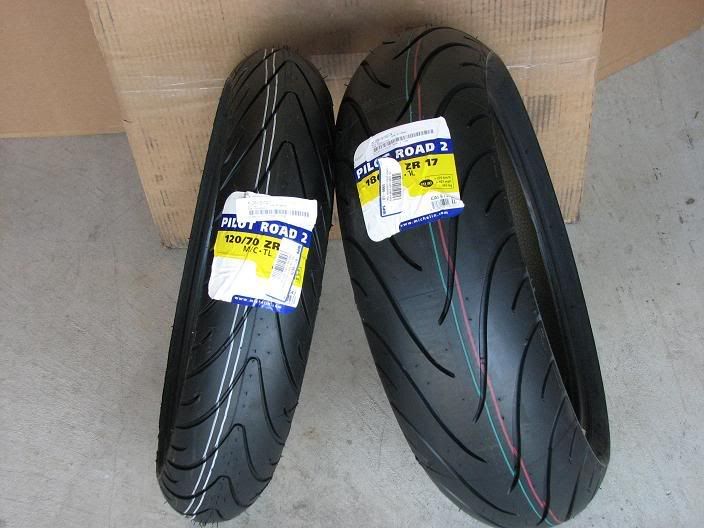

They're pilot roads 2ct. Don't remember how many miles off hand. Ya know, I don't seen any wear bars on these tires...  [roll]

second ridge from the label going down. where the red line is. if yours dont look like that then you already worn them down.
erkishhorde
Hmmm... I looked for that when I bought it and couldn't find it. I'll look again.
