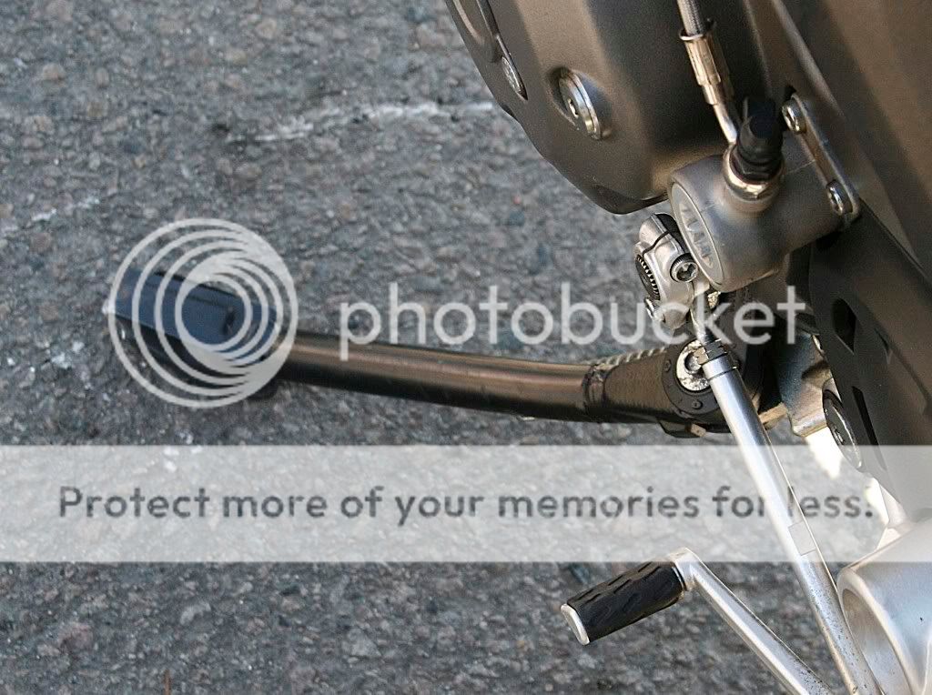

Kind of a longshot, but I'm trying to get out of paying $173 for a replacement kickstand for the bent one on my 696.  Can't find one on ebay.  Does anybody know if one from a previous model monster will fit?
Alternatively, am I just asking for trouble if I try to bend it back manually?

What material is it? ive had luck bending aluminum ones back (those were on the S2R models), with the iron ones you could use a mapp torch and heat it up and hammer it back into place.
if you take a snap shot of how the 696 stands look like, i could tell you if an S2R would work or not.

I'm pretty sure that it's tubular steel.
'09 Monster 696
it looks like it mounts the exact same way as a 695, and i know for a fact you can put an S2R stand onto a 695 so it might be worth a try.
Id try using a torch to heat it up then hammer it back in place while you source that out.

Interesting.  I'll look around and see if I can find an s2r/695 stand.  Thanks for the info.
