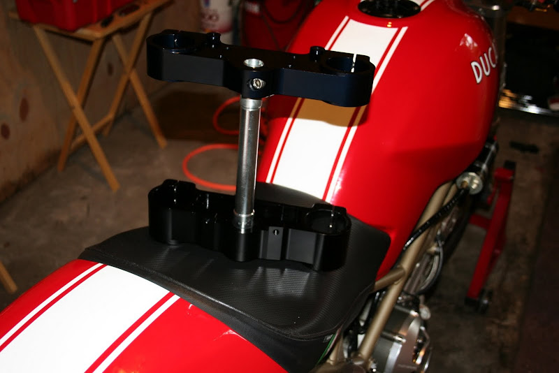

« Reply #3 on: January 11, 2010, 08:36:01 AM »
IMA SrL absolutely fit, and come with "options". The Costa's are great to work too.
Options include Anodized Color, bore diameter (53 - sbk, 56 - ohlins, 54 stock), and the offset is 30mm, which gets it to the same as the newer (02+) monsters. Much less expensive than SpeedyMoto AND you can get a matching top triple as well. They make them for 94-01 Monsters, all Superbikes, and 02-09 Monsters. You will have to provide your own tapered bearing set to replace the stock ones, but that's no big deal. They come with stainless bolts and holes drilled for headlight U-bracket and turn-stops on the lower, and the upper has holes for handlebar mounts, fairing mounts, and whatever else you might need (like even the mount holes that I believe was for the brake manifold used before brake lines were more easily T-junctioned.)
Here is it installed on mine, I have another thread about it somewhere.

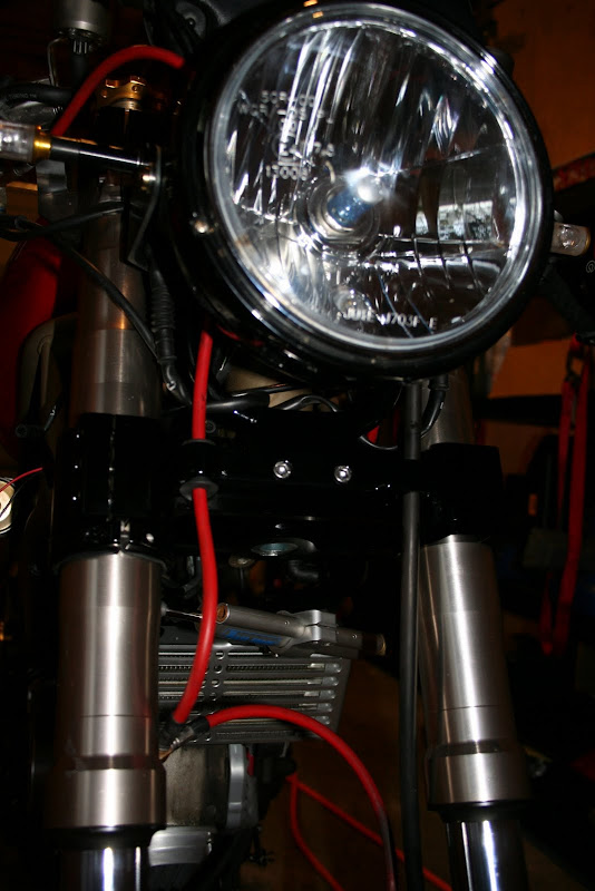

« Reply #10 on: January 18, 2010, 05:28:00 AM »
The bolt at the top triple on the bottom one looks suspicious. Pre-02 Monsters don't use the same style as the newer Monsters, and that looks like a new Monster top nut. Old Monsters use a big bolt that screws into the stem. Otherwise, those look fantastic.

« Reply #12 on: January 19, 2010, 12:47:57 AM »
it's an ss set - they used that 8 hole 916 style nut on the ie bikes even tho it's the same set up as the early monsters and ss underneath.
