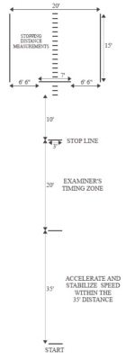

Run #3: Quick Stop
The quick stop (below) is one of two timed maneuvers. The rider begins on a start line and accelerates for 35 feet, stabilizing the motorcycle's speed between 12 and 20 MPH. A 20' long timing box is then entered; the box is usually defined by two sets of cones.
When the front tire reaches the end of the timing box (second set of cones) the brakes are applied and the motorcycle is stopped as quickly and as safely as possible. Unlike the controlled stop you do not earn deductions for skidding, although it isn't encouraged.
There is a standard distance based on your speed and you earn a 1-point deduction for every foot over that standard. In practice if you use both brakes properly you will be within the standard with room to spare.
There are several portions of this test that cause trouble for many riders. Points will most likely be deducted if the rider uses only the rear brake. An automatic failure will be charged to riders who end up skidding and dropping the motorcycle, so don't get carried away.
The last potential trouble spot is either going too fast or too slow or anticipating the stop. Examiners will be looking for any attempt to brake before the stop line, but if you do you will get one more chance at it in this portion of the test. You also get a second run if you are riding too fast or too slow, so take a glance at your speed. Remember the 12 to 20 MPH speed limit; 14 to 15 MPH is ideal.

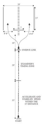

Run #4: Obstacle Swerve
The Obstacle Swerve (below) is the second timed test with the same target speed of 12 to 20 MPH. The rider will begin a swerve either to the left or right as directed at the second set of cones.
Thirteen feet from the swerve line (10 feet plus the 3 one-foot hash marks in image below) is a second line which is 7' wide representing a car and 6'6' to the outside of that is a vertical line. The rider must swerve through the 6'6" opening without touching the 7 foot horizontal line or the vertical boundary line to the outside. It is a 5 point deduction for touching the boundary. If you are too slow you get one more chance.
