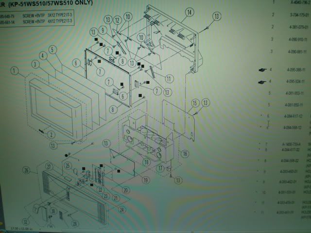

  I have a 2003 Sony KP57WS510 that needs some work done.
The service manual shows the screen in 3 layers. Can i take those layers apart and clean them individually?
There are some funky looking places around the bottom corners. Looks like moisture seepage with maybe a touch of mildew.

  [laugh] yeah, that would be bad. I've been looking around for a new screen, just in case. They're virtually impossible to get.
I did find a place that can get me any or all 3 pieces, but they would cost more than i paid for the set new. :o
Anyway, i took it all apart last weekend to do a few other repairs but didn't try to disassemble the screen.
Downloaded a copy of the service manual. This is what it shows.
#'s 3, 4, 5 are taped together with what looks like electrical tape. I just wasn't sure if there might be some sort of glue or other sealant between them. To keep air out or some such nonsense.

Quote from: hooligan machinist on February 13, 2010, 08:09:01 AM
i'd have to see what the labels for those parts are, but the stack is likely a fresnel screen, a lenticular screen, and a protective (possibly anti-glare) screen.
the parts that are taped together should be the lenticular/fresnel screens. i seem to remember them needing to be in alignment with each other.
they should just be taped on the outsides to hold their alignment with each other.
