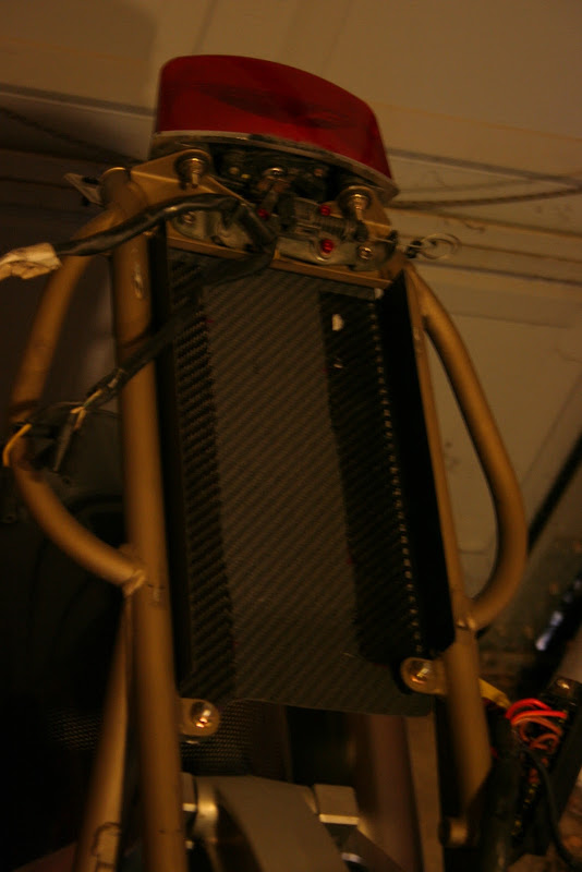

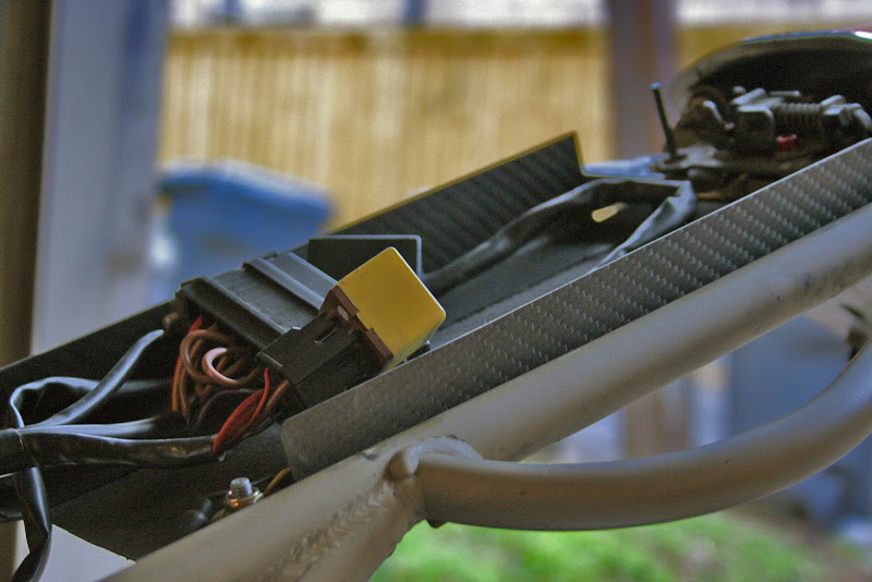

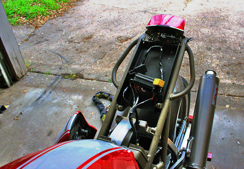

« Reply #19 on: February 23, 2010, 04:39:10 PM »
I've begun working on this for my bike. Using carbon fiber sheets and light-duty angle to make a box/tray like shape. Since my ride-height is jacked up, I've been able to actually use aluminum spacers to lower the tray, and free up a little room underneath the seat.
STILL A WORK IN PROGRESS, WIRING/FUSEBOX HAS NOT BEEN FIXED IN PLACE...YET
