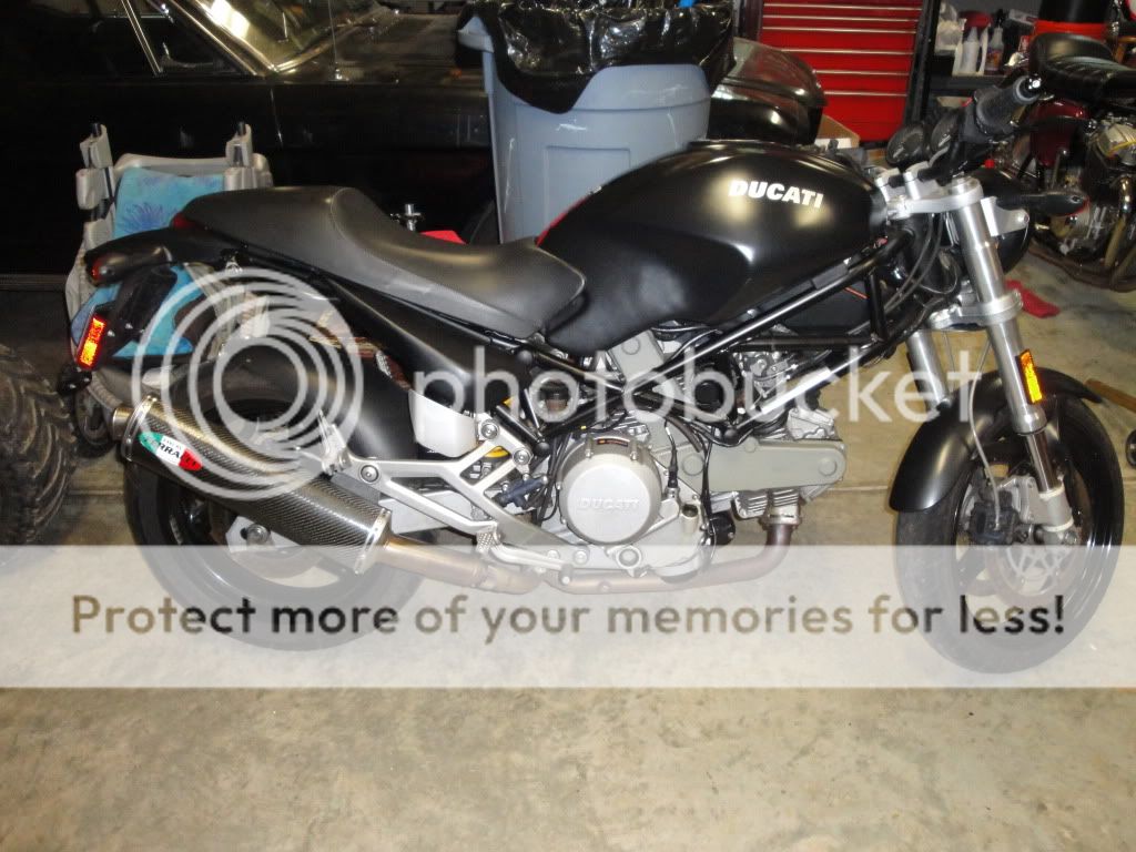

1999 M900 City Edition: Open Clutch: After Market Cans

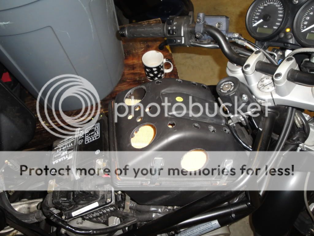

After I took out the air filter (it was Clean) and checked the intake (it was clean too), I started it up and really revved it for a while...
I felt the power coming back, so I got my helmet and went for a ride. It was running rich and sputtering a little, but I was able ride it through 1-2-3 gears.
