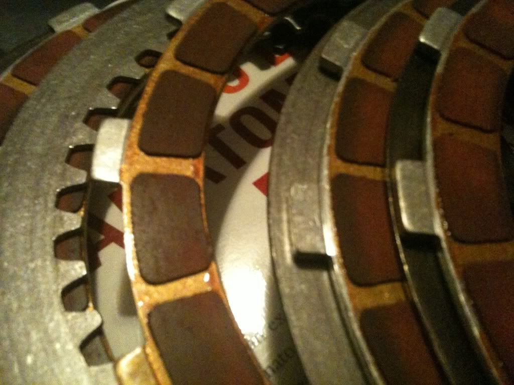

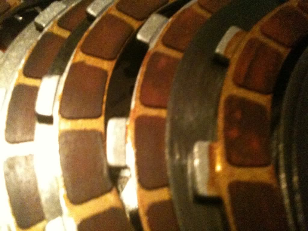

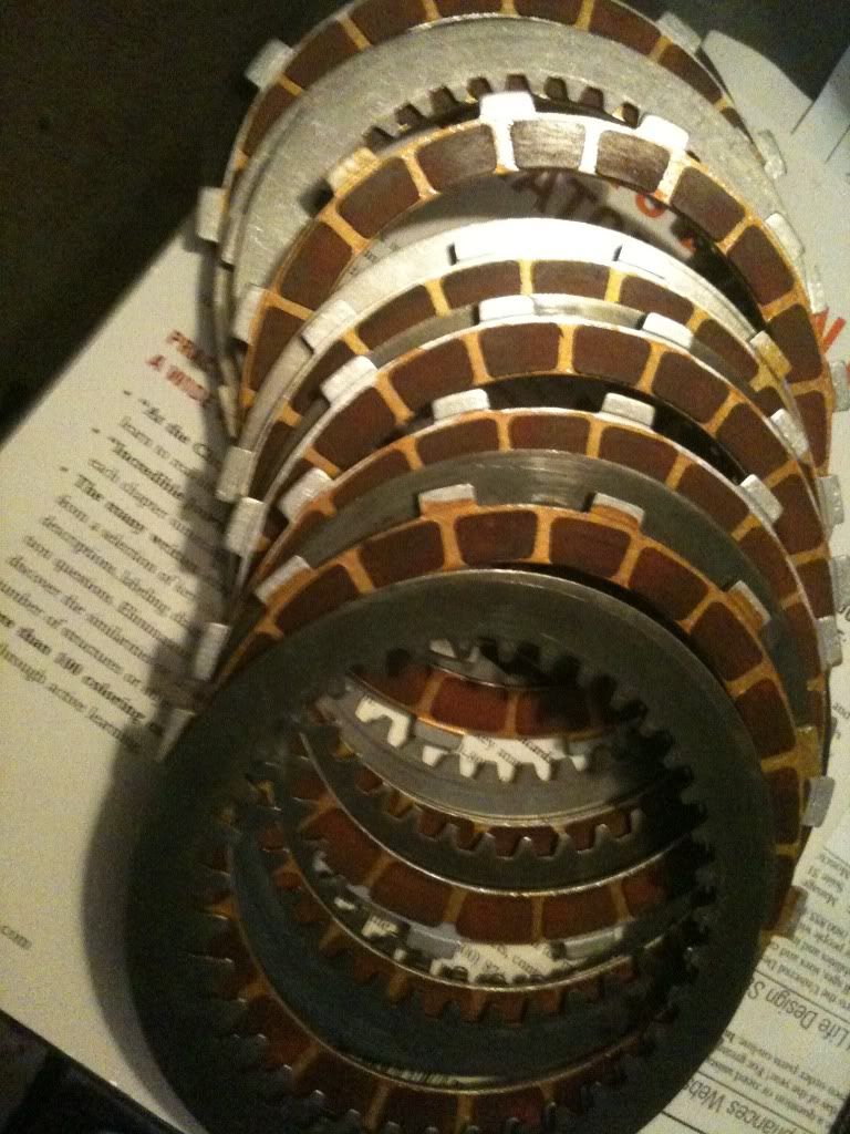

Ok guys I'm at a blank here I got some barnett clutch plates for a really great price..... But he tells me that I can use them on my dry clutch. But I have also been told that it is for a wet clutch... So I want to see what you guy think. I have googled and search and really haven't had much luck, the barnett site says it can either be used as wet or dry...
Herr some pics
when I look at that them they look to smooth to use, but who knows [laugh]
spankinâ,,¢
they look alot like my Barnett clutch pack for the dry clutch.
Ddan
It wouldn't take 10 minutes to put 'em in and try it.  If they work,  [thumbsup], if not  :'(
Not much help, am I.    ;D

Quote from: Paper5tr3et7 on June 16, 2010, 03:46:39 AM
look like dries to me
thx  [thumbsup]

well i put them in last eve and rode to work this morning
they feel pretty good [thumbsup] i mean so far so good! plus with the slave cylinder its just like butter again...
i will ride throught the weekend and post an update. But im getting the feeling it will be good

one more question guys...where are the wear marks are on the plates? maybe im just looking wrong or blind, but was curious? and when do you typically change the clutch basket?
spankinâ,,¢
Quote from: Glitter Princess on June 17, 2010, 05:26:40 AM
YOu mean like the grooves a brake pad might have? If so, there aren't any. One can go by thickness if you have calipers... or just eyeball it. IF they are looking thin and shabby... time for new ones.
There's no typical on a clutch basket. Some people like He Man thrash 'em out real fast. I replaced mine at ~28K, though it could have kept going for a while, but was getting some good grooves resulting in a lot of extra noise.
theres a spec in the haynes manual for +/- 2mm of travel beyond normal, and it "should be replaced"
my stock ones were pretty thrashed but not out of spec at ~8,000 miles. Again it really depends on how you ride, where u ride etc. my bike can be on for 2 hours, but i only made about 25 miles, and i have 18,000 miles right now so it doenst show how many hours my bike was on but just not moving.
