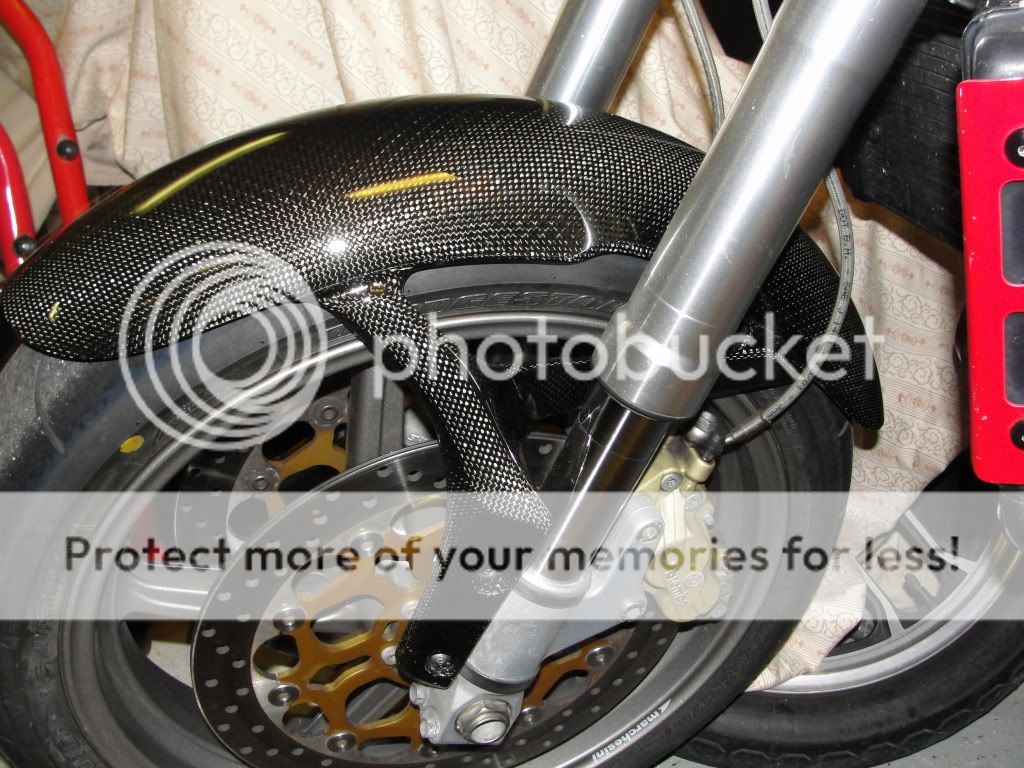

I snapped some crappy pics tonight and they don't do it justice. But who cares? Pictures are fun to look at!
The bike is red. Flash made it look all funky
After much debate, I decided to clear that son of a pregnant dog right in there
I'm happy with the way it turned out. A little bit of time, research, elbow grease and  [drink] go a long way. The only bad part is that the rest of the bike looks terrible now. It's a vicious cycle
