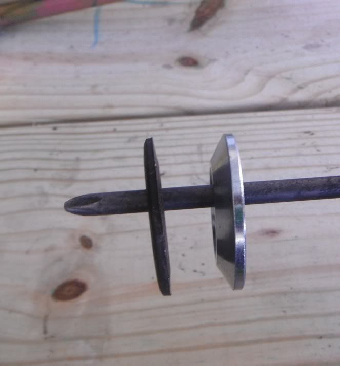

otter1
Finally got this part today - $12.80 + $8.00 shipping  :P
Old one vs new one pic.
Sweet jebus - that should not have happened. I've got a 2000 headed towards 36K and aside from a different coating my spacer still looks like the one on the right. I'd have a good look at the swing arm, sprocket carrier, bearings, axle, caliper carrier and caliper.
