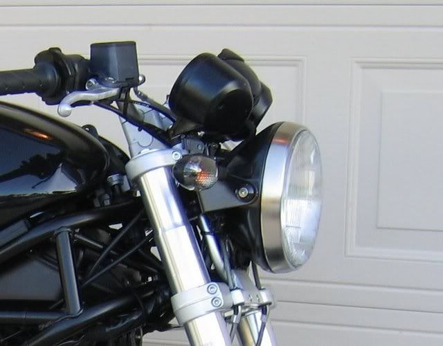

I used emery paper to take the shine off my chrome ring.  It now has a brushed finish.  I think it was sanded all in one direction for the best look.
It's not a close up but you can see in this picture that the chrome shine is gone from the headlight ring.
I did the same thing a few years earlier on my 620.

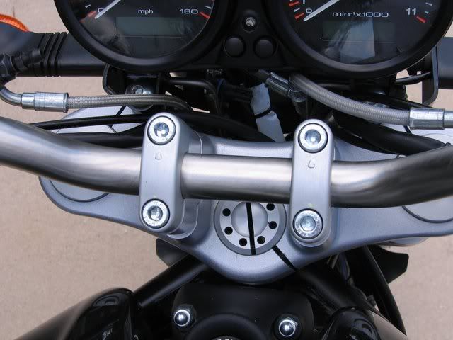

I also took the chrome shine off the handlebars.

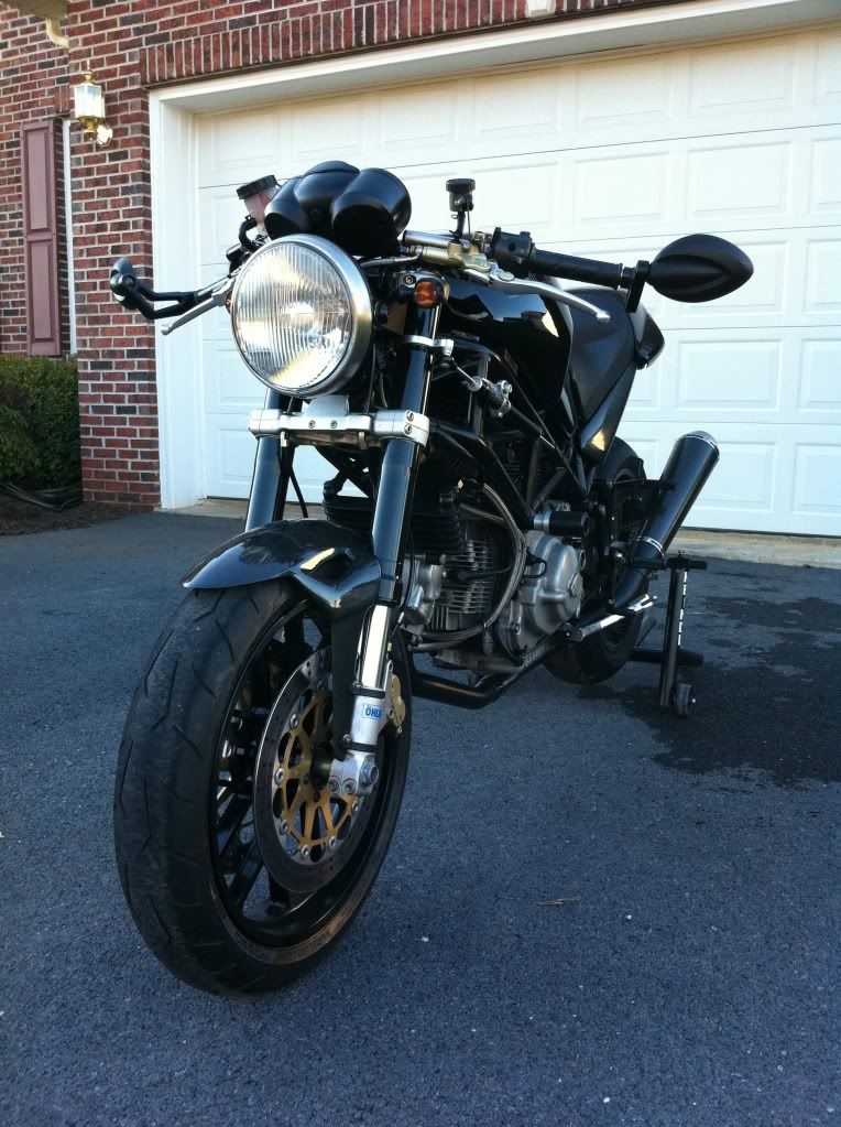

As an alternate to painting the supports I covered them in black reflective vinyl. Black in daylight - reflects white when hit with a directional light.
Trav - looks nice. Did you clear it after or just leave it?
Quote from: Sad Panda on March 23, 2012, 11:17:28 AM
No need to clear. It is simply scuffed up chrome.

The brushed look handle bars look awesome i asune  you took the bar off ? Or did you blag it with it still on ?
