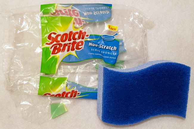

also, for removing the liquid gasket that is already on there... i messed around with a lot of tools to do a good job, and found that the BEST one was actually a BLUE SCOTCHBRITE KITCHEN SPONGE. It has the soft blue scrubby on the one side, which will not scrape, scratch or mar the aluminum at all, but did an AMAZING job at removing the gasket maker.
