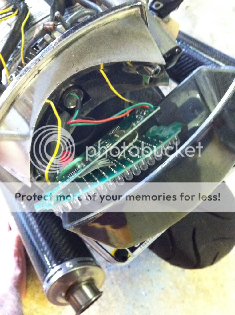

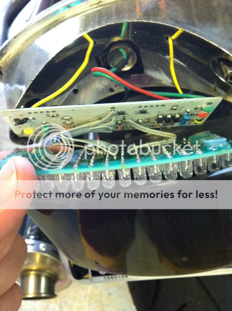

Seems my tail light has been blinking on and off. Not in the way it is supposed to be either.
I suck at anything electronic so I'm not even going to try to explain what I found. Let's just say that the light came on when I would place the two halves together.
The point of this post is to learn why this is happening. I just kind of want to learn something. What am I looking at and why does the light turn off when one half is pulled away from the other?
I suppose it is time to look for a new one.

sounds like a loose connection between the wiring and the board......but it could be something else entirely. i went through two of those (LED) tail lights before i went back to stock.

This is kinda a shot in the dark without seeing what's going on first hand, and just going by the pics....
Maybe the peaks of the solder on the board is piercing the insulation on the wires causing it to short circuit.
Try placing something between the solder and the wires.
If I were to guess, just by looking at the pics, I'd say look at the wires near the 3 black doo-hickies near the blue doo-hickey.  That area could be a pinch point.

I took it to work and let the guys in "e-world" have at it. They found a few wires loose and soldered everything back together.
I took it home, hooked it up and it works fine.
