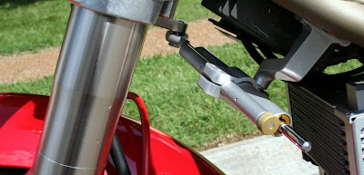

Additional Pics of the Motowheels Billet Under-Triple Damper and Ohlins "Generic" Damper setup:

Quote from: ato memphis on March 27, 2009, 10:06:31 AM
Thinking of buying this set-up. A few questions:
(1) Second picture - where does the damper attach at the non-fork end? I cannot see from this pic too:
(2) Apart from the steering damper, do I need any other bracket?
Cheers

In the 2nd picture I posted (red bike), you can see that the bracket holding the damper attaches to a bar on the frame. That big silver L-bracket.
You buy the damper and the kit, two items.
