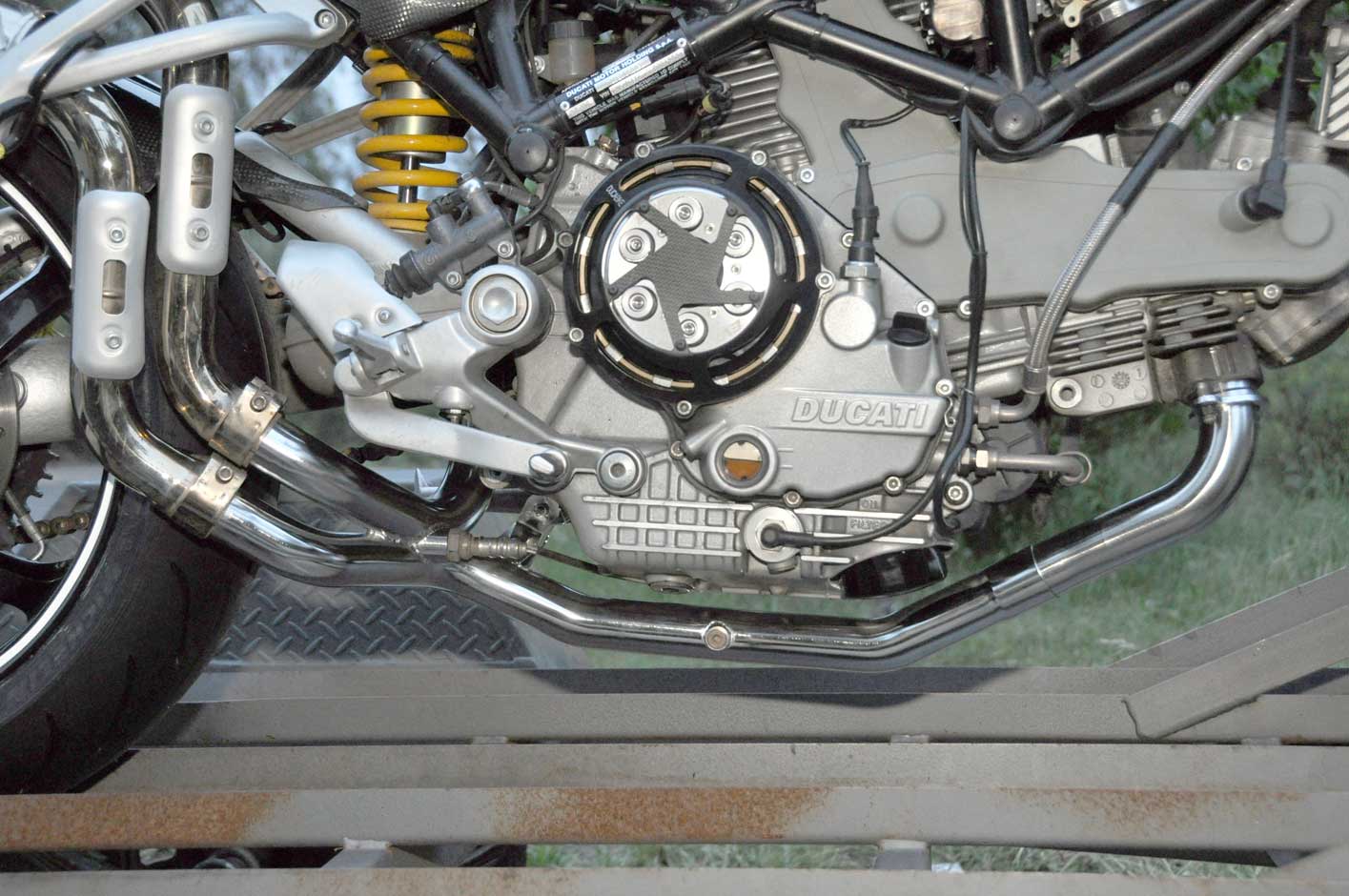

So if all goes right tomorrow I'm picking up a low mile Grin S2R 1000. I'm looking for a full exhaust. The picture of this mid pipe looks like the front pipe bolts right up to the cylinder. The couple of videos I saw on You tube look like the cut the stock head pipe a few inches down and bolted this mid pipe on.
Anyone that has these can you please clear this up for me?
http://motowheels.com/i-6922404-spark-monster-s2r-1000-midpipe.html

My impression is that most S2R1000 midpipes were one-piece (as the one you link to), but this from DesmoWorld show a two-piece (maybe like those you have seen on YouTube).
http://www.desmoworld.com/shop/ducati-monster/s2r-s4r-s4rs/auspuff/auspuff/s2r-1000-kr-mmer-by-spark.html
Probably no difference in functionality... maybe a little easier to mount a two-piece, but also another joint to make sure doesn't leak...

S2R1000 and S4Rt/S4Rs midpipe goes all the way to the horizontal head.
S2R800/S4R have a stub pipe on the horizontal head.

Spark midpipe does indeed have a stubby bit out of the front cylinder.
Makes it smaller to ship. It's held onto the rest of the midpipe with springs.
Snapped one of the retainers little arm things (so the spring fell off) down at Phillip Island but it still seals Smiley. One day I'll weld the front part. One day.
Has been going well for the last nearly 4 years I have had it on the bike.
