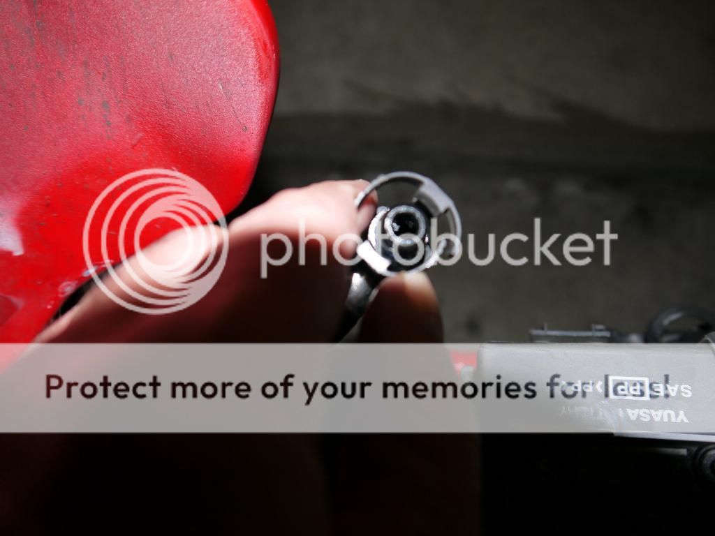

My S2R threw fuel on my leg yesterday - engine just died, my leg felt cold and I could see fuel pumping out.
As expected the quick release connector's ring/tab is broken and it won't stay in place.
New being picked up tomorrow.
Any advice about this job - just plug & play?

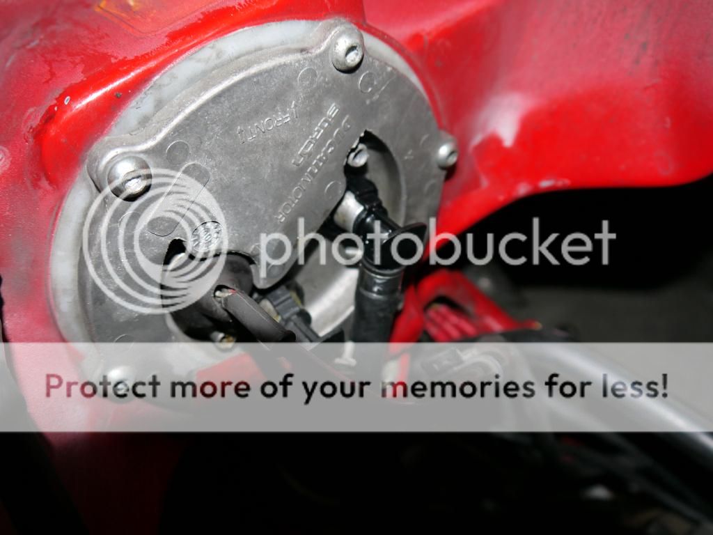

is this the first time you are replacing them? asking because of the particular design of the hose clamp
Yes, first time - at 108,000 km - 2007 model.
I didn't study the clamp in depth, but I remember it as a normal clamp with a bolt to screw out and in.

.... I fixed the actual job. No issues, straight out and almost straight in. Nice and tight - runs - no leaks yet.
Plastic ring that tighten the locking tabs was broken in two places.
Too tight hose clamp?

Cool. At least you can torque up the clamps and not crush the fittings.
