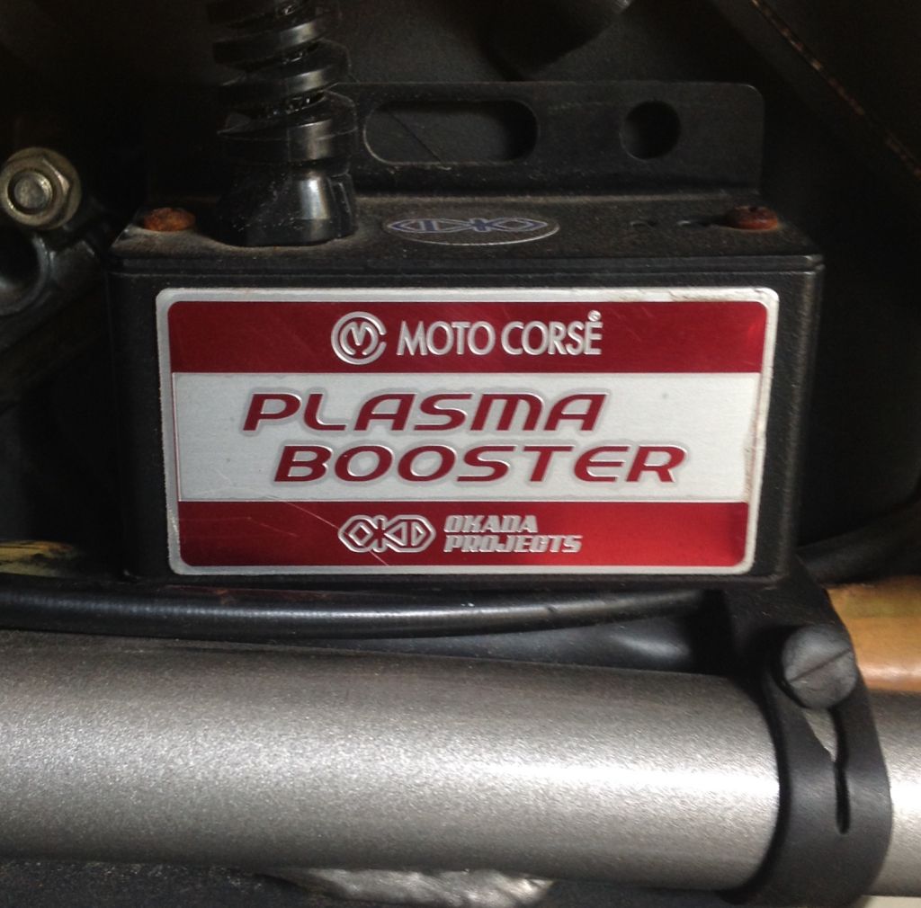

On a side note the bike has this fitted:
It's a Plasma Booster, it's connected to the coil wires plus to the each side of the carbie there is also a black earth wire and then a brown wire that looks as if it come loose and I have no idea where it goes! Could this be causing the problem?

brad black
doubt it, but i'd piss it off anyway.

MonsterMadMarty
Quote from: brad black on January 21, 2015, 05:12:18 PM
Why's that? Is it just a gimmick?
brad black
the wires to the carbs are the heater kit.  nothing to do with the box.
the carbs are different internally, so even with the same jetting a 900 carb will work differently to a 400 carb.
