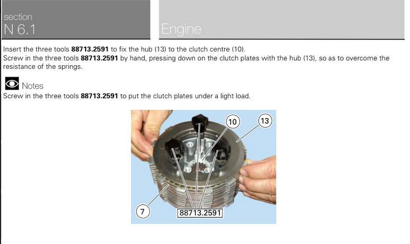

After looking at the service manual for the bike though,  it appears that the 696 clutch is laid out a bit different and it recommends using a special ducati tool?  Does anyone know if this is totally necessary?  As seen here:

Not totally necessary, but it makes the job easier/less frustrating.
I've heard you can substitute the special "tools" with threaded rods.
The tools will keep the clutch assembly in one piece during removal/insertion and also clamp the unit while you undo the big nut.  They no longer have the black plastic hand knobs - you tighten them with a socket.
I opted for the three special tools AND the billet basket holder.  These are specific to the unique APTC "slipper" clutch.  Normal Ducati clutch tools won't do any good here.
edit - here's a pic of the tools in action on my bike:  http://www.ducatimonsterforum.org/index.php?topic=24411.msg1068048#msg1068048
