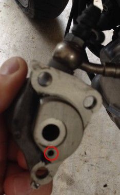

Yesterday, I noticed a few drops of oily fluid under the bike after it has been parked for a few days (2-3) on the side stand.
Appears to be coming from the clutch slave -- as some have predicted.
I took off the clutch slave and the fluid seems to be coming from a small hole machined into the inner surface of the slave cylinder.
I did not see anything in the service manual about clutch rebuild or what that hole is supposed to do...
Circled below:
Before replacing the slave, I wanted to make sure that it is indeed malfunctioning.
Is this due to a worn seal or o-ring? Is it an "overflow" mechanism and some leakage is normal after bleeding?
If it is due to a worn seal there a rebuild kit? My dealer did not seem to be able to answer that question.
Is it better to just replace the slave?
Do you recommend a used OEM? Aftermarket? If so, Oberon for $150?
Thanks!
I don't know if it has to be replaced, but if it does, I believe OEM is less expensive than aftermarket (for a change).
The APTC clutch is, IME, sensitive for clutch rod travel - it needs the full travel of a 26mm (OEM) to cover the distance from fully engaged to fully disengaged. 28mm is ok, but 29 and up ~not suitable. The tiny drag you get with larger slaves is probably not critical, but something to consider.
elcom
Replaced the slave with a used OEM. So far so good.
