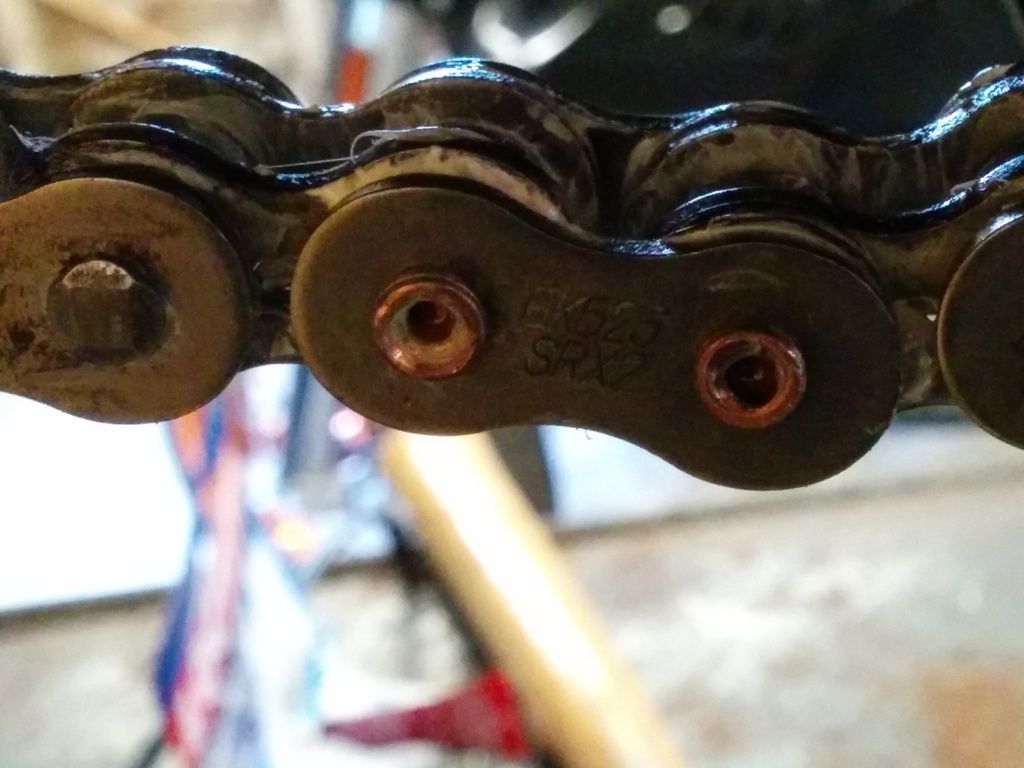

Good?
The diameter of the one on the right is .008" less than the left one.
The heights of the heads to the plate are within .002"
Am I good?

Looks good to me.

The peen looks fine to me as well. Though the hardest issue is making sure you didn't over-wrench the rivet link together. It should flex and not stick when twisted.
Measure the thickness plate-to-plate, should be the same as the factory done ones.
As EEL said, it shouldn't bind when you flex it.

Geez, I didn't even consider the goop.
I didn't measure the width but I know the master moves fairly freely since I did at least check that.
