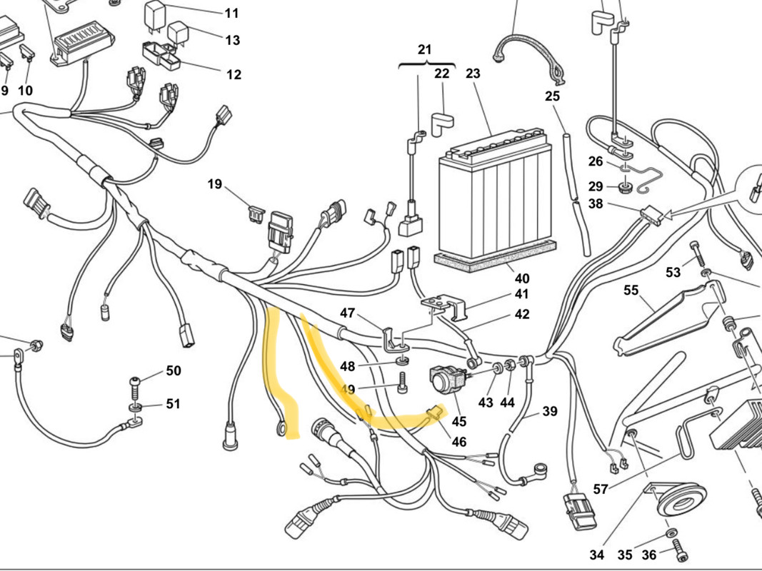

I know this isn't very helpful, but the two wires in question are in yellow.
According to the vague reference, the plug goes to the solenoid. The other is the one in question.
Does this help any, or just compound the question?

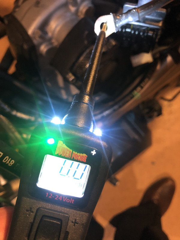

I'm pretty damn sure the ground I showed in my picture is the *entire ground* for the whole bike, except for the starter motor.
If the positive wire is connected to the battery, and that ground wire is floating in thin air, it'll show 12v on it.

Correct, the two large wires shown in my pic attached to the solenoid, one connects to the positive battery terminal and the other to the starter.
Your harness has a large wire going from the starter solenoid to the connector on the end of the large wire that attaches to the positive battery terminal.
Your post of the parts diagram has correctly ID'd the wires with the yellow highliter.

I put the power probe on it and it's 100% a ground.
I connected one end to a ground and the other to the lead in question and there is zero current.
Also the power probe detects a ground with a green light and hot with a red light.
Thank you all for your help, MUCH APPRECIATED!!!
