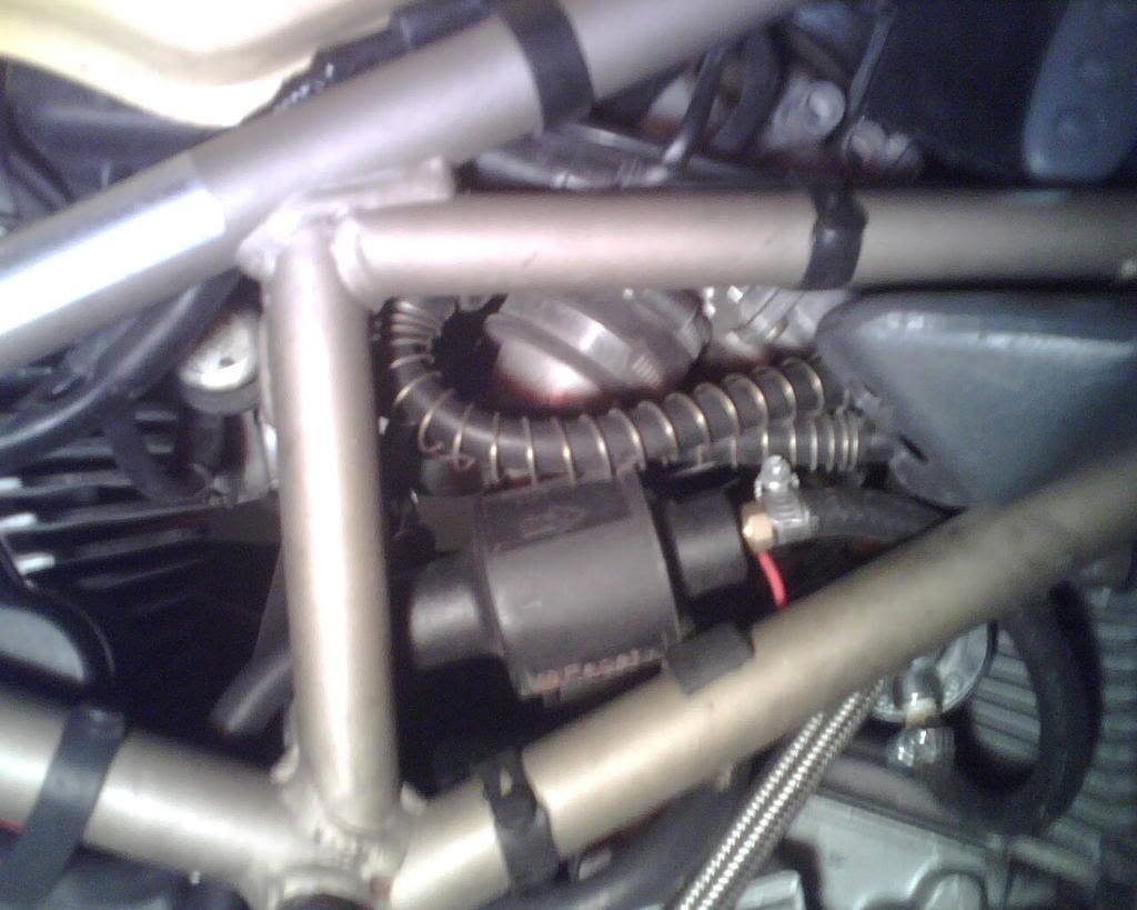

Bet you a dollar its the fuel pump. Mine was doing the same thing till I ditched the oem vacuum pump and replaced it with a small low pressure electric one.  The diaphram in the oem pump quits diaphraming over time. There are a few rebuild kits out there. I do have a rebuild kit that I didn't use but I'm in Texas. Ill have to find it so I can get a part number and supplier for you.
This is my setup.
This is a Facet brand low pressure fuel pump from Pep Boys.  I believe you can run this without a pressure regulator but I decided to run one anyway.  The pump fits snuggly so I just used some wire ties and some old coolant hoses to isolate vibrations.  The reason I went this route was because the closest oem fuel pump rebuild was 3 weeks away and I didn't feel like waiting.  I removed the oem fuel pump and plugged off the vacuum port with a vacuum cap.  Wiring the pump in was a simple affair.  I just ran the ground to a hidden point on the frame (pod mount) and ran the red wire back to the fuse box and wired it in to its own fuse.  If you loosen the fuse box and turn it over, you will see that there are 3 or 4 empty fuse slots that are not used.  All the fuses are key on power only so I just used one of those and it has been flawless for the last 8000 miles.  This shouldn't cost more than $50 bucks for a do it yourselfer.

Alright, after a night's sleep I'm ready to try this. I'm not quite sure what a vacuum port is but there aren't a whole lot of hoses going into the tank so I'm pretty sure I can figure out which hole is the vacuum. Also, for the power for the fuel pump, could I use the wires that go to the existing fuel pump instead of wiring into the fuse box? I assume I could get some hose from home depot too, maybe tygon tubing?. Also, how does the pressure regulator work?
Porsche Monkey
The original fuel pump for this bike is a vacuum actuated type. It is not electric. Look for the pump on the right side of the bike. It is mounted with two screws on the vertical frame tube just behind where my fuel pump is mounted in the picture.  It is shaped like a pentagon if I remember correctly.  There should be three hoses coming off of it. One supply hose from the tank, one hose that goes up between the carbs, and a smaller hose that goes to one of the intake manifolds. The smaller hose is the vacuum line and that's what needs to be plugged. When you buy your fuel pump pick up an assortment of vacuum caps and you will find one that fits. Your gonna want to remove the vacuum hose completely and put one of the plugs over the port on the intake manifold so you don't have any vacuum leaks. You should also buy some small hose clamps, some electrical wire the same diameter as the wire on the new pump and maybe an assortment of electrical connectors.  I didn't have to add any length to the fuel line so you should be okay there.  The fuel pressure regulator I used is just a Mr Gasket brand dial type that should also be available at the auto parts store. You want to get the smallest low pressure pump possible and I believe that is the Facet brand.  Look for the plastic body one instead of the metal one.  The metal ones are loud and the plastic ones are very quiet.  Post back when you get that far.
