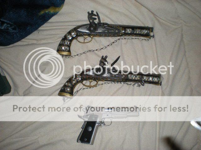

Back from the dead but here are my guns.  The top two are from Afganistan that my dad picked up.  Both are made 1833, the other is a para special edition 82nd Airborne 1911, which my dad had left to me.  I love it but it will miss feed once fouled up with the cheap stuff.  Will this get better once everything 'breaks in."
what kind of barrels do the Afghani pistols have?  are they Damascus type?  I'd love to check those out.
does your 1911 have the GI type half feed ramp or is it a full feed ramp?
the GI version has problems with anything but ball ammo since the half ramp can catch on the projectile.  some makers have redesigned the frame so the barrel has a full ramp (like the Hi Power and every other Browning style gun after...)

Good questions, I don't know but I will gladly take pictures of what you need.  I'm going to the range with some HP's so I'll let you know how those do.  As far as the Afghani pistols, I wouldn't know but I will google Damascus barrels once I get some free time.  Or...I can take pictures for you.

a Damascus barrel is a VERY old way of making a barrel whereby you use a rod and drop strips of metal around it and then pound them together.  it is only usable for black powder, low power charges.  it was how barrels were made in the 17th century.

Pm me your email and I will send you detailed pictures of the pistols.  The 1911 shoots a hell of a lot better with +p ammo, and the HPs where not a problem.  The cheap stuff they sell for target practice, however, is CRAP!

sounds like you need a lighter recoil spring!
