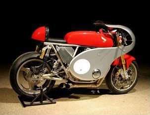

Johnny OrganDonor
The cb750 is a great base for a cafe project.  Here's one that a friend of mine did about six years ago.  Sorry about the small pic.
MrFryMoto
Quote from: Johnny OrganDonor on March 01, 2009, 02:28:54 PM
good looking bike!
i keep toying with the idea of a full fairing - but i think i'll keep it naked
looks like he's done some pretty interesting mods to that
