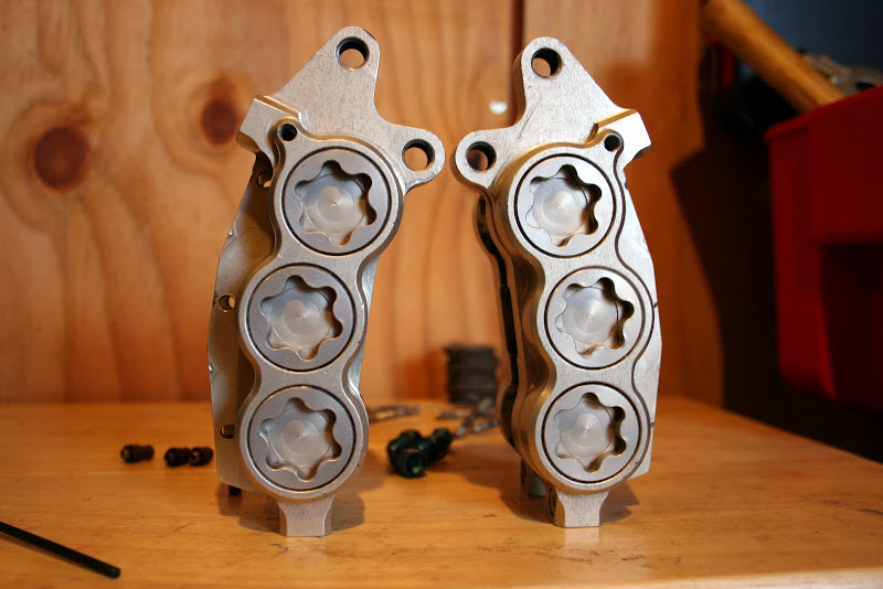

these won't be going on for some time. I'm going to gut and rebuild them first, which means waiting on the specialty tool to remove the piston caps (bore cap tool is essentially what I don't have, not the same was those on yamahas), the seal kit and some other small parts.
They weigh right at or under the OEM brembo's on the bike. My bike has the single pad set, single pin, 40mm mount. These use 3 sets of pads per caliper (6 total pads) and have some cool features in the design, such as cups to keep the pads from falling out if the rotor is there even if the pin has gone awol, very well built. This set came off an RC30 and they show a bit of use. Fine with me, you can rebuild them to new with just a little bit of time.

pretty

those things are crooked

? whatcha mean?

is that a Gov patent design cause them crooked.

They follow the curve of the rotor, hoss.

I know that, just giving you shyat

Well, knowing you, I thought you might actually have gotten confused with the mechanical nature.
KIDDING.
