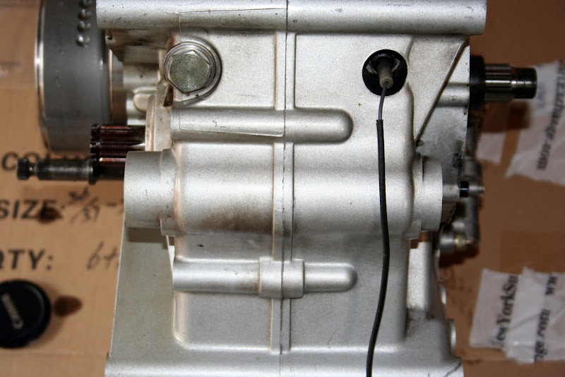

I do. They are not symmetrical. i need to hold a sbk swingarm up next to it to see. It would also help to see a sbk case side to see what there is to do. I can't imagine dremeling into it with the bearings still inside the case... Don't see how to push them out either... Thoughts?

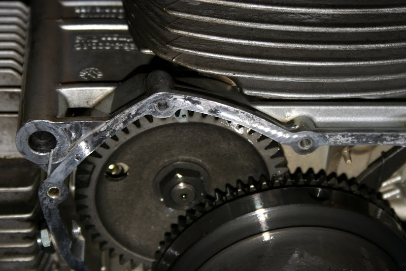

Getting camera out tomorrow. Alternator side case cover...off. everything looks good except the bearing that goes on the end of the alternator coil. Either I broke it, or it was broke, but little ball bearings fell out onto my floor when I flipped that case over to set it down, and the inner ring came out too. perhaps i was a little aggressive in my removal with the tool, but nothing was out of the ordinary in using it... Oh well, its only a $13 bearing and I want to replace as many as i can get to easily anyhow.

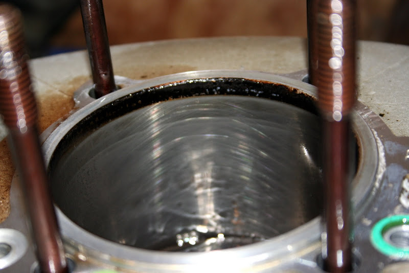

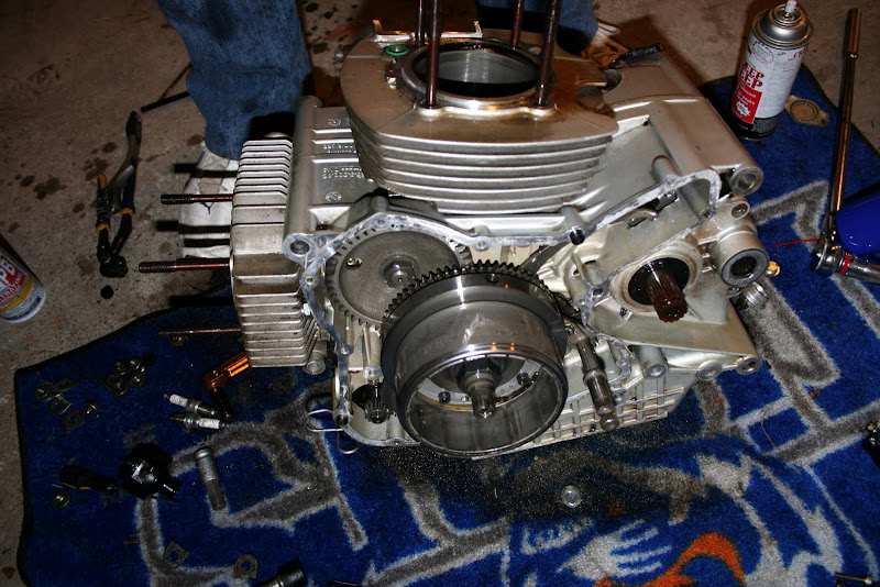

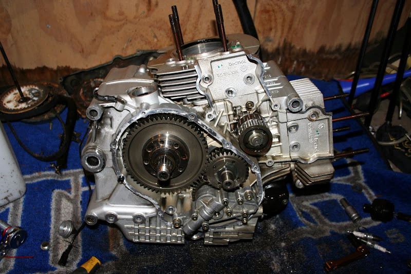

Alright, here are some pics of the motor's internals. everything looked good...
My sophisticated "catch-all" door mat that my wife no longer lets me put out front was employed temporarily before I could get a nice tray and some cardboard:

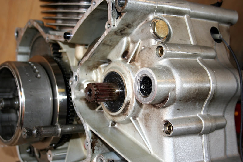

This motor mount looks good,
but the other side (not pictured), has a hairline fracture on the motor mount region that protrudes past the cases. It seems like an easy weld fix, but I've never had to deal with this - thoughts on risks? I want to know before I invest more time or money into any other parts.

1) Additionally, is there any hints or tricks to removing the swingarm bearings in the cases?
While I had planned on splitting the cases to have the crank balanced (and lightened, polished, knife edged... possibly) for either 94mm or 95mm pistons (944 or 964cc) and light rods, I figured this would be a good time to pull them out if they have to come out from the middle... but I was hoping to mock it up in a frame before I ripped into its guts.
The current plan is to have the heads done up, race cams put in with mbp collets, and then powdercoated (not red, unless they are MBP done up).
I was going to put in some higher strength cylinder studs when it all went back together, but I found removing stock studs incredibly difficult... Tried using two nuts tightened really tight to each other, but they would both back out when I cranked hard on it.
2) If planning to use an Ignitech ignition to make it fire with carbs (removing the "IE" designation all together), I'm trying to figure out how to use the IE timing sensor. I found a thread (http://www.ducati.ms/forums/showthread.php?t=56514) that talks about 46/2, and I'm trying to figure out how the pickup sensor works on the IE motor. Is it picking up the two "recessed" teeth on the gear pictured on the top left of that last picture? That gear has two teeth that do not sit 'flush' with the rest on the outside face, and there's also a small dot somewhere else on the gear.
Wondering if its possible to wire up that sensor to an Ignitech unit to send sparks to some dynacoils, and then to the plugs.
I figure, the other way would be to throw, if possible, a carb'd 3-phase flywheel on and set up the carb style pick-ups bracket.
