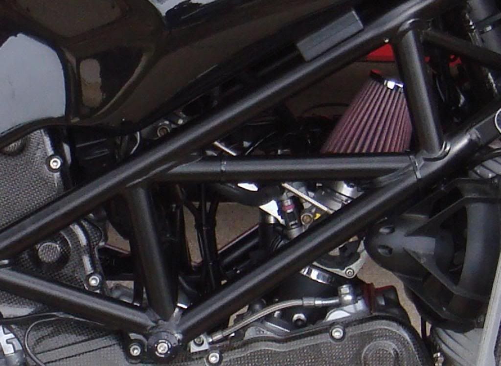

I have the DP ecu and removed the stepper motor and capped the unused air fittings.  I also installed a fast idle button off a ?996? I think, it replaces a part of the throttle housing.  Works pretty good.

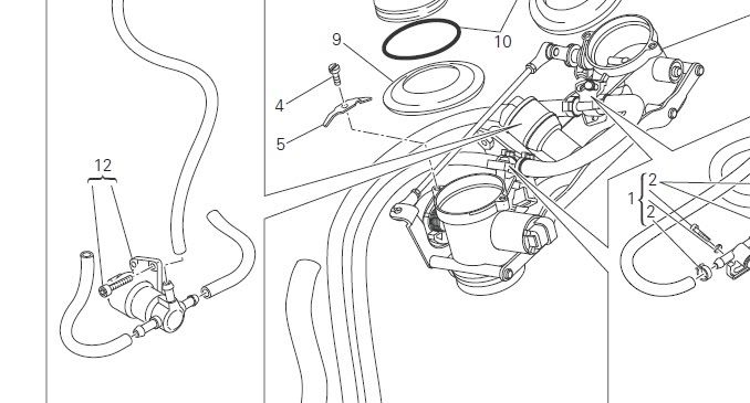

Pardon my ignorance, but what/where is the stepper motor?  I seem to have this issue as well.
Bill in OKC
It is an air valve that bypasses the throttle plates so the computer can control the engine speed.  The valve takes filtered air from the airbox and passes it to the TBs under the butterflies.  The stepper motor controls how large the opening is in the valve and it is like opening and closing the throttle.  Part #12

I removed mine because I didn't like the way it looked, never had an idle problem.  I wanted to clean up the engine, hard to do with all the hoses and wires, but I tried.  I also removed the airbox and relocated the radiator overflow bottle.  An idle lever wouldn't work for me because there was not a bracket to hold the extra cable.  The throttle bump from a 996 works ok but it is kind of fiddly to get it adjusted right.  It works with the stock throttle housing - push a button and it bumps the throttle grip a bit.
