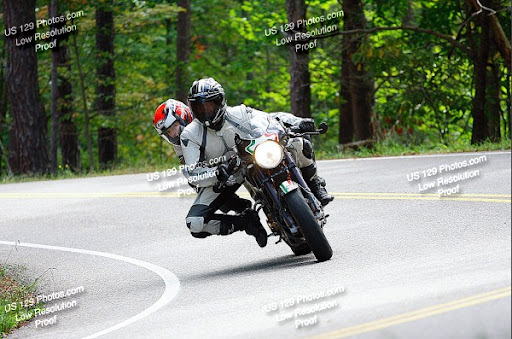

I'll walk you through a corner.
(Note: in these pictures I'm wearing boots two sizes too large for my feet, I wear size 11 and these are 13 and a half. It might look like poor foot positioning, but I really do have the balls of my feet on the pegs. I know, I know, sounds like an excuse.)
You approach your corner of choice, say it's a right hander, moderately tight. You brake hard. When you brake you usually move your weight as backwards as you can. With a pillion, you don't have to be as aggressive with your weight shift, but you need to engage your core a lot more to keep your passenger from sliding forward. Taking the weight on your arms spells disaster. As for your passenger, she needs to put her arms around you and onto the tank, and push back to avoid smashing into you. Trust me, your bits will thank me for it.
You can see in this pic where I'm holding myself up with my core, elbows slightly bent and Desmolu behind me has her arms around me pushing off.
Before you start setting up and looking through the turn, you must have finished 90% of your braking. You can trail brake if you want, but I mostly use trailbraking as a tool to correct a line if I have to. You both start setting up and looking towards where you want to go, while starting to position your bodies. It is extremely important that your pillion is looking towards where you're going. She should move with your back with her head slightly below your shoulder.
You continue setting up for the turn and make sure to look where you're headed. This picture might be a little exaggerated but you can tell we're both starting to hang off and lean. Also, you start tipping the bike in. When you're riding with a pillion, you'll be surprised to know that if you're hanging off right, you can actually go faster through a corner without having to lean the bike quite as much. This happens because of the added weight you have to throw into the inside of the corner.
You both try to get your heads as far down as possible. You need to hold yourself up with your legs and core, not your arms. If you look closely, my arm is relaxed, draped across the tank and I'm using the inside of my thigh to hold myself up. I could actually have better form and have my leg a little tighter against the tank. Desmolu is doing the same thing. You pillion needs to hold herself up with her legs and core and use only the hand on the outside of the tank as a guide. You can see how relaxed her arm is.
This pic really shows your pillion's ideal body positioning. As we approach the apex, Desmolu is completely holding herself up with her legs, her upper body is leaned towards the inside of the corner and is mirroring mine. I bet she could raise her arms and nothing would happen. We still haven't finished leaning, and If you see closely, you can see the forks are compressing a bit from me adjusting the line through trailbraking.
Basically same as before, You can see I'm done trailbraking and am about to hit the apex.
The photographer missed us hitting the apex, but this is a great shot of right afterwards. you can really see Desmolu's body positioning. One of the beautiful things about riding with a pillion is that you have so much weight over the rear that you can really hammer it after the apex without having to worry so much about the rear slipping out. That thing stays so planted it's beautiful. If you're really going at it you can drive the whole bike out of the corner on one wheel. You can tell by the chain  and rear suspension that I'm driving out a nice clip.
Now on this one I'm starting to transition for the next corner.I'm starting to stand the bike up and Desmolu is getting ready to follow me, but she doesn't move until I start doing it. You have to be really adamant about the fact that your pillion moves with you and not before you. It can turn really if he/she moves before you and you end up overshooting.
Note: Except for the first one, the pictures were all taken on the same corner by two photographers with slightly different vantage points.
And that's about it. Not much to it, really.
Have fun!
/ I might be completely wrong in everything I said, these are just my observations from doing it on my own.

My experience has been that me keeping my body low and her head/torso slightly inboard is all it takes. I'm saying this as a comment to your pictures, in which it looks like you're hanging off without really needing to.

A very big +1 on pillion NOT moving until the rider does.
Good write up and cool pictures [thumbsup]

Thanks, we have different riding styles you and I. I like to hang off more to ensure I have more flexibility to lean the bike if I have to later in the turn. I find it a lot safer to add more lean mid turn than to hang off more. Having to switch up your body position while in the turn can be very unsettling for your suspension. I also do a lot of track days and translate my riding style to the street.
