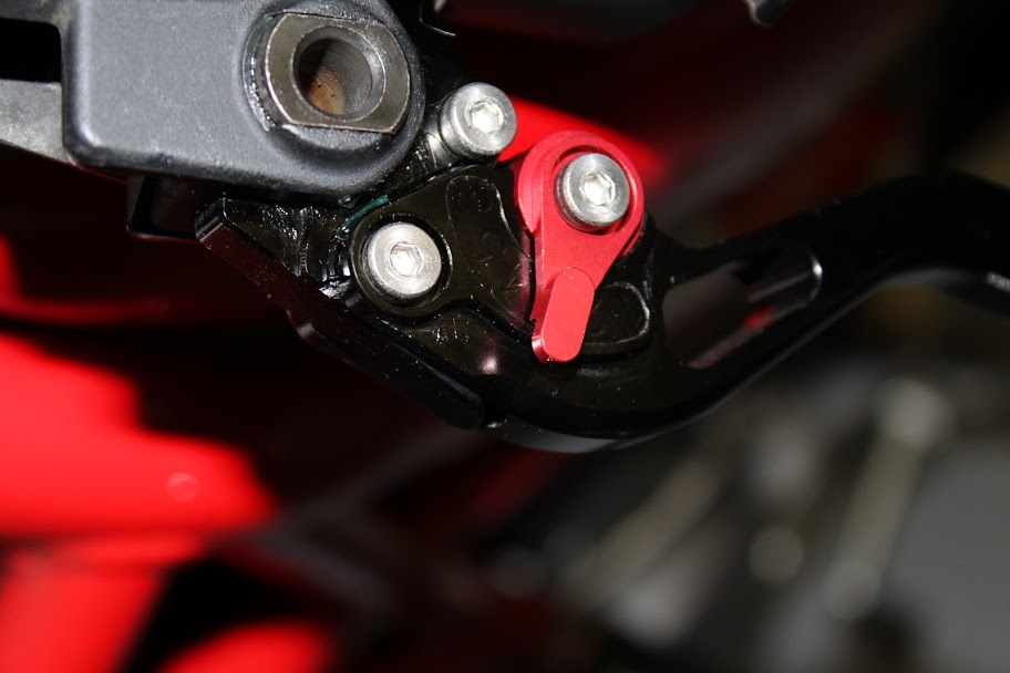

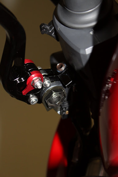

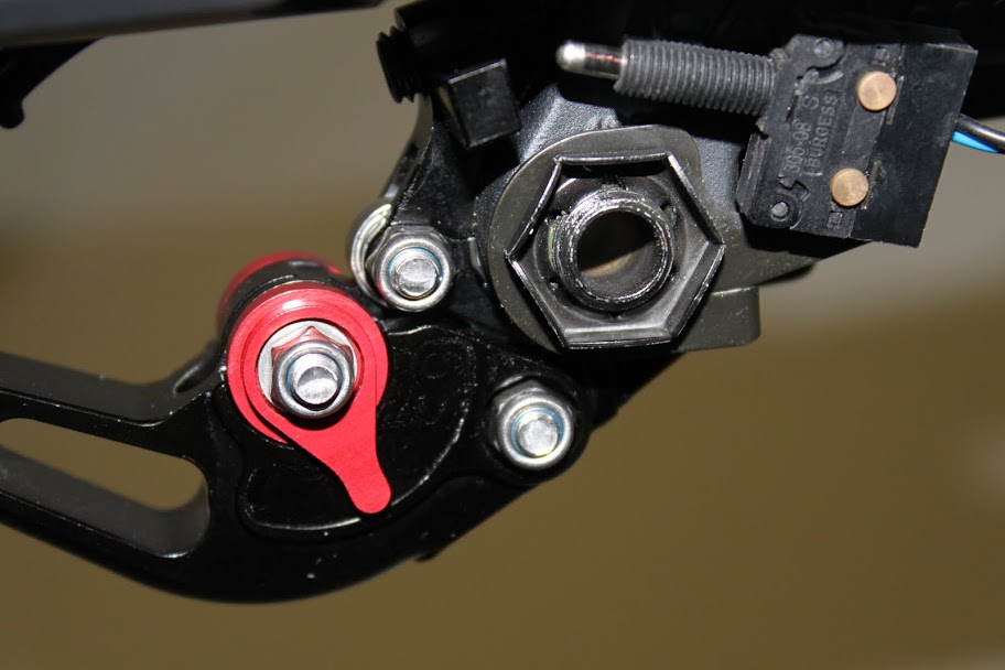

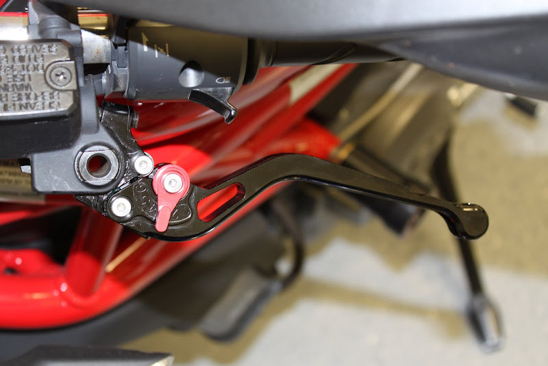

So I got the M.Label levers for about $75 shipped.
I installed them a couple of weeks ago. Piece of cake, as you might imagine.
I too sense a little bit of a wobble, but I don't have another set of adjustable levers to compare them too. It's not bad, and it doesn't seem to have any bearing on the use of the levers. I can see how adjustable levers probably would wobble more in general, because you have two points of connection, to the perch and to the first part of the lever, instead of just one with standard levers. So you'd expect more movement, even if both joints are just as tight as the original.
There was one tiny flaw in the finish I touched up with a Sharpie, but overall, they look nice.
The quality seems good. I was actually hoping they'd be a little more rounded off, the leading edges are smoothed but still have a bit of a corner to them. However with gloves on (and we all ride with gloves, right?) you cannot tell one bit. The adjustment action is very smooth and positive.
As for the main reason to get adjustable levers: yea they rock. It's SO much easier to manipulate the clutch when the friction zone is closer to the grip, at least in my opinion. I also moved the brake a little closer to the grip and I like that arrangement much better.
To clarify two points: These levers have both the freeplay adjustment screw, AND the clutch switch tab. So I was able to adjust the freeplay to my liking. I just added a little locktite to the screw. And the bike still starts in gear with the clutch in. This is for the 696.
Here's some pictures:
You can plainly see the clutch switch tab here:

thanks for the pics... SOLD
