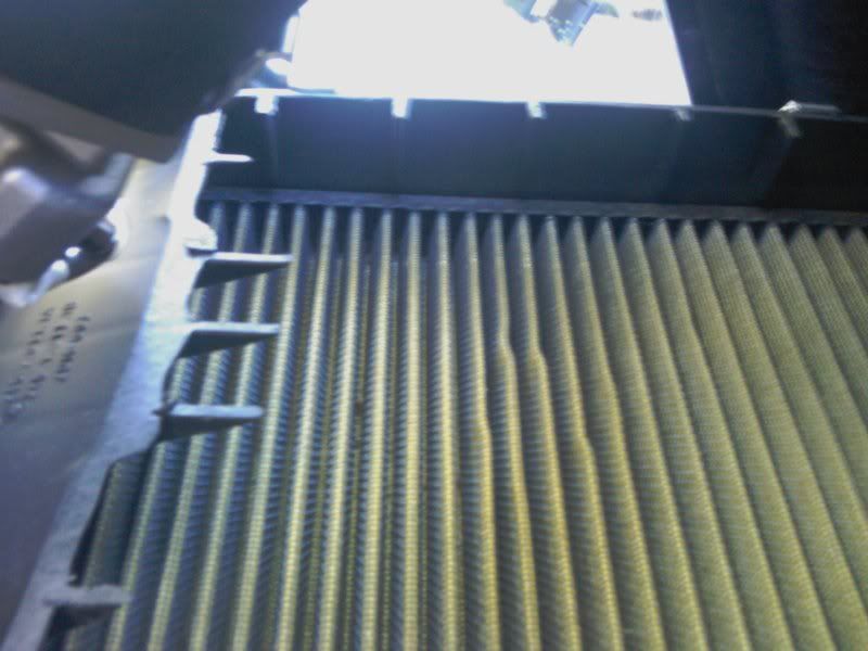

Interesting ideas about airflow.  Per Speeddog's advice, I am going to slap the airbox lid from the 695 on real quick to see how the bike runs.  I looked at the airbox again and it seems obvious that it was chopped, it is not a Termi airbox lid, so I'm doubting that the slip-ons and ECU were bought as part of a slip-on kit.  I would like to re-chop a used airbox lid in a way that will block rain a little better than the current lid.

Does the open airbox lid that comes with the Termi kit look like a stock airbox lid that was cut with a hacksaw by a 12year old?  Mine literally just looked like the top was sawed off.  I'm trying to determine if the previous owner installed a Termi kit or just pieced together the ECU and pipes then cut the airbox.

From what I have seen, the kit comes with a red high(er) flow filter that fits in the stock airbox. I don't think it comes with a new lid, just the filter.
