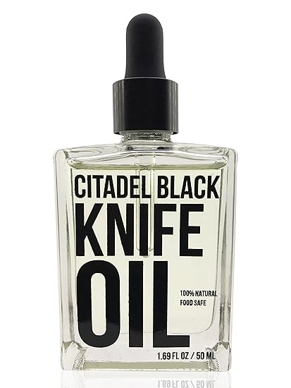

Now, there’s a knife specific oil called CITADEL BLACK KNIFE OIL.
https://www.amazon.com/dp/B01M1JGZ3W
It’s getting pretty good review, but take a look at what I have been using before placing an order.
Japanese Tsubaki (Camellia) oil.
https://www.amazon.com/KUROBARA-Tsubaki-Japanese-Maintenance-Camellia/dp/B00362HBPQ
That’s what  I’ve been using on my non-stainless steel blades for all these years.
The black thing in the photo is an applicator. While it is not necessary, it is a pretty handy tool to have.
https://www.amazon.com/Sakai-Takayuki-applicator-Maintenance-Aburatsubo/dp/B00U3PLGWI/
I usually buy stuff like these from here. (They are local, to me.)
http://www.hidatool.com/miscellaneous/camellia-oil-and-tool-maintenance
Now, compare CITADEL BLACK knife oil to Kurobara brand Tsubaki oil.
CITADEL BLACK knife oil is $13.97 for 50 ml (1.69 fl oz.), and it’s a mixture of white mineral oil and camellia oil.
Japanese Tsubaki oil is $8.99 for100 ml (3.38 fl oz.), and it’s 100% pure camellia oil.
CITADEL BLACK’s product description says “The perfect blend of White Mineral oil and cold-pressed Camellia seed oil also known as Tsubaki Oil”, but doesn’t tell you the ratio. And, mixing mineral oil (with camellia oil) has no effect on the function of the oil, but greatly reduces the production cost. (You have no idea how many % of CITADEL BLACK  oil is camellia oil and how many % is just a plane mineral oil.)
If you want  to pay extra $ for fancy packaging and advertisement, go ahead, jump to Amazon link and order it.
It’s not a bad product. It’s just massively over priced product.
And, they send free sample to famous Youtube knife reviewer, and they put out a product review video like this.
