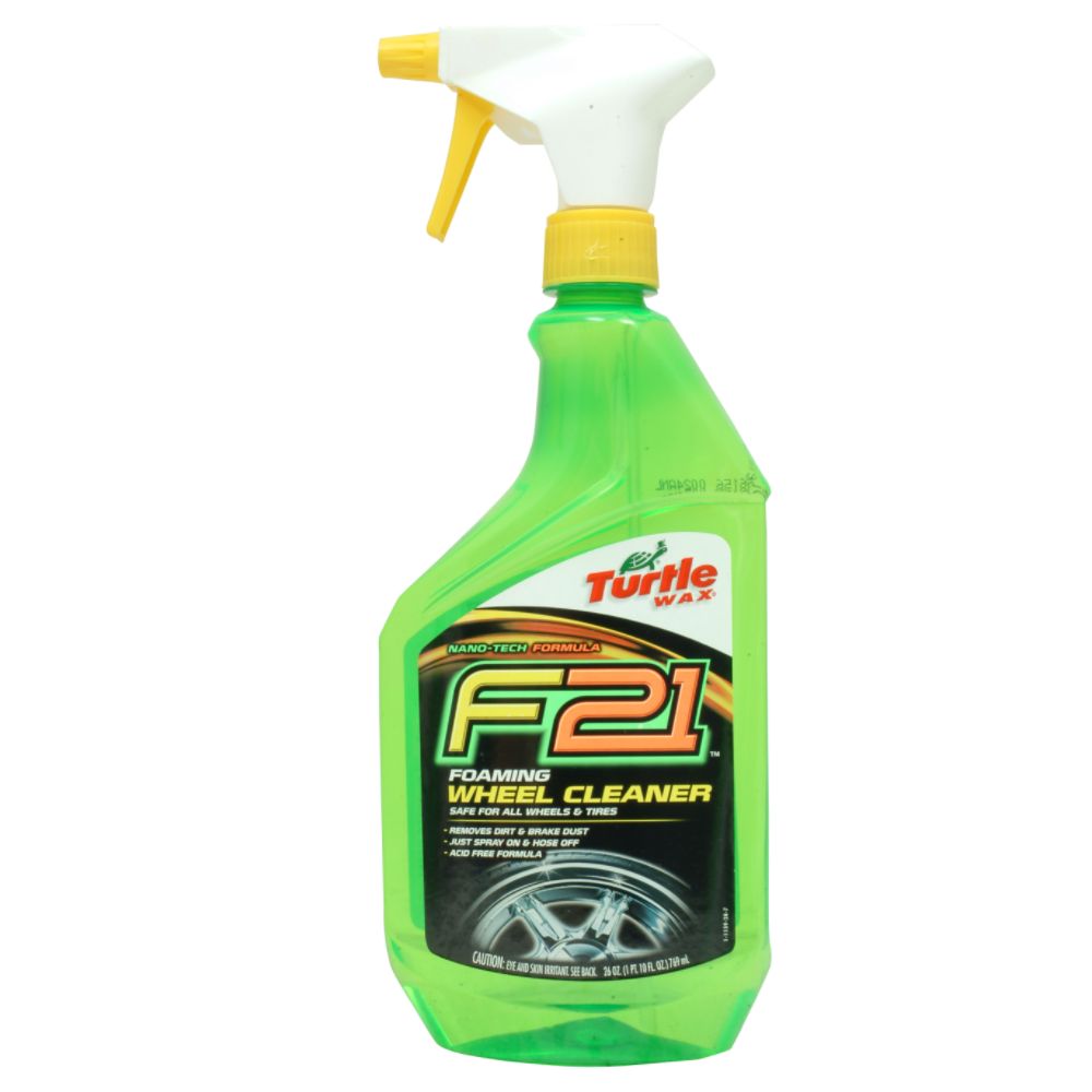

Hand dish soap, warm water and plastic nail brush.  I picked up a dozen of these brushes for $5 at Advance Auto.   You can also use most "wheel cleaners" as they are designed to use around wheels -- painted, chromed, etc  -- without hurting the finish or brake pads.
best job is to take the pads out, brush them off separately and clean the caliper while mounted.
Alternatively, you can use a high pressure hose, just go lightly around the hose and joints.
Some brushes are harder than others, which is why I say to use the nail brush.  They are softer.
Wheel cleaner - just rinse well.  Zero problems.

I wouldn't bother with it, there are so many other options.  Wheel cleaner is design for (drumroll) wheels and brakes of all kinds.   Never had a problem with finish or affecting the brake pads.
