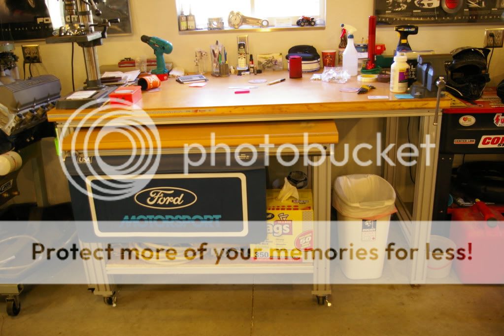

I went with particle board tops on the two I made for my shop, and used 8020 aluminum extrusion for the framework.
My main bench is made so that the smaller rolls under it when not in use. It cost a shitpile of money to build up front, but they're almost indestructible and rock solid.
I can post pics later if you like.

Here's what I mentioned above:
The vise and drill press are just lag bolted to the top. I have the rolling bench pulled out a bit for the pic; it tucks completely under the stationary unit.
The beauty of the aluminum extrusion is that you can bolt stuff to it using the T-slots after the fact. For example, the green thing on the left leg is a plate I machined to hold my razor blade dispenser. Ditto for the fender cover hanger bar.
Like I said, they are stout. I assembled the stationary bench upside down, and I had to get help to right it.
