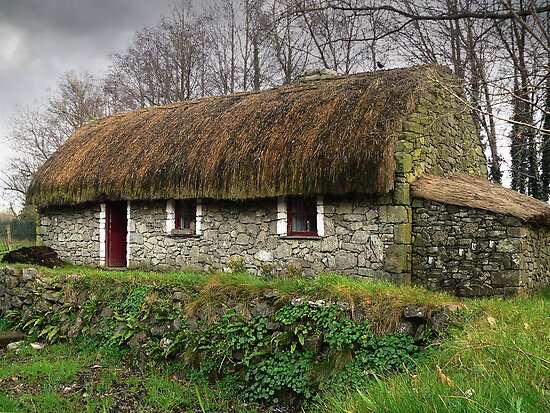

i have moss on a section of my roof too...
don't worry... in ireland everyone's doing it...  [thumbsup]
