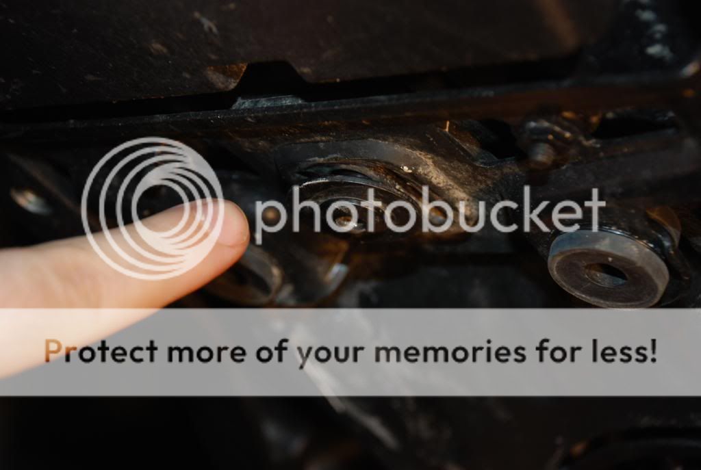

I'm assuming you mean this bolt. My exhaust bracket is removed so yours will look a little different.
Raux is correct it's molded into the tank with nothing on top to hold back with.

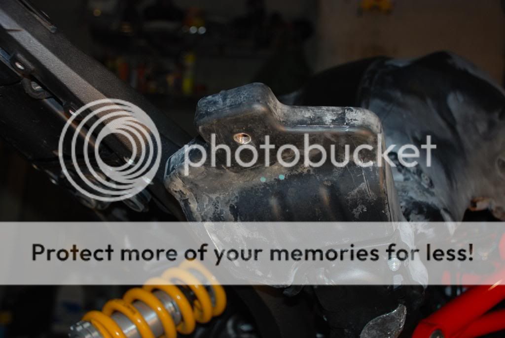

Top of tank

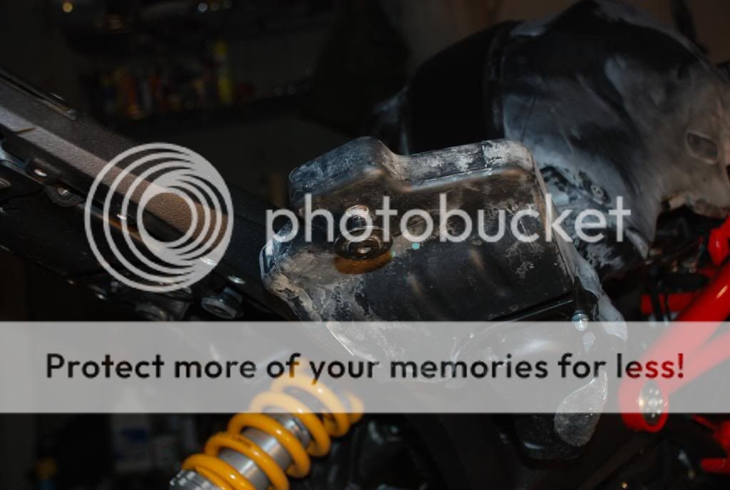

Bottom of tank

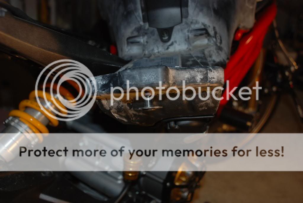

Screw put back in after tank removal
So I still agree with Raux that the plastic has stripped away when you intially tried to remove it.
Other than that it should pull right out.

Here....  No nut, but the allen bolt which is moulded into the tank has an accessible allen head... see?
into which you can insert an allen key to prevent it from spinning in the pastic.... thus..
Whilst this cant be seen  ??? ??? ??? in DN's pic below...
...I cant believe they made 2 different designs, I'm guessing in the moulding process DN's and perhaps yours too got a thin layer of plastic over the top of the allen head hiding it?  Maybe have a gentle scratch around that area to see if you can reveal it?
